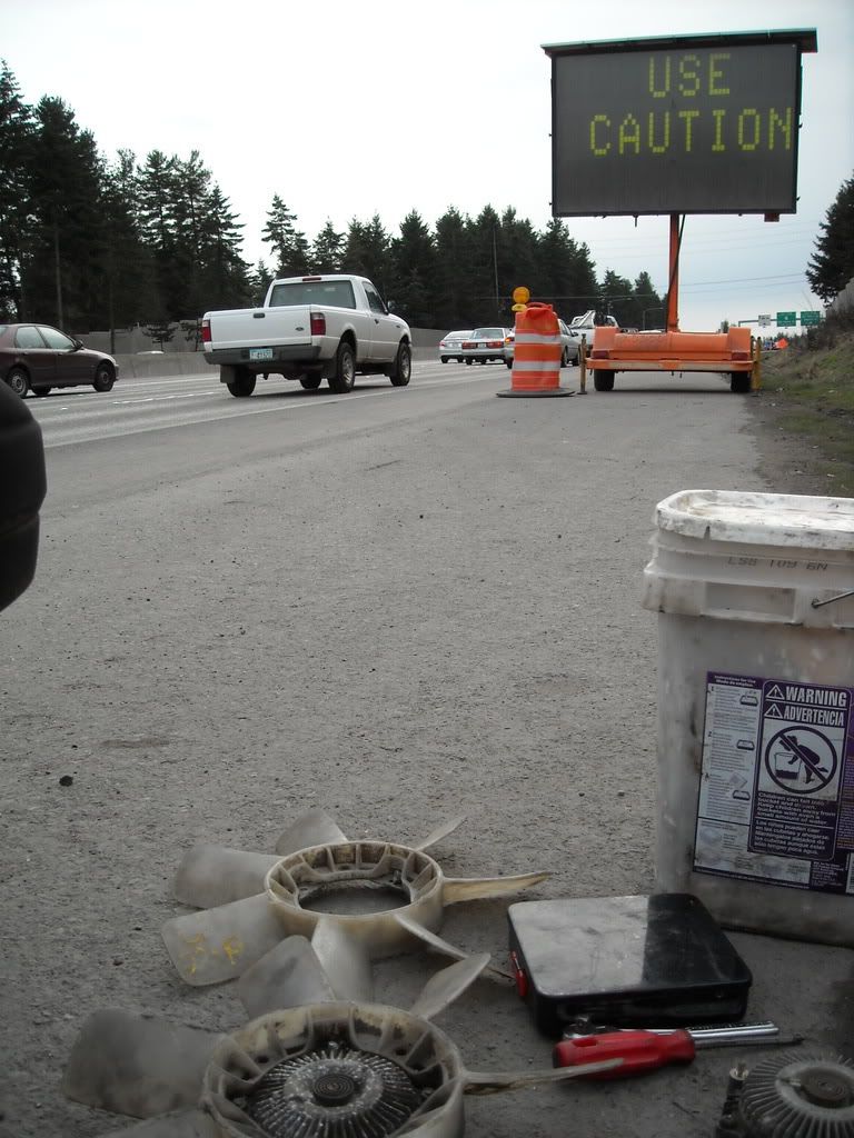

the freeway emergency update...
traffic's a &$#*% in a car that sat for awhile...
had the tools, got to work.

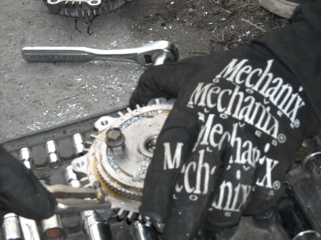

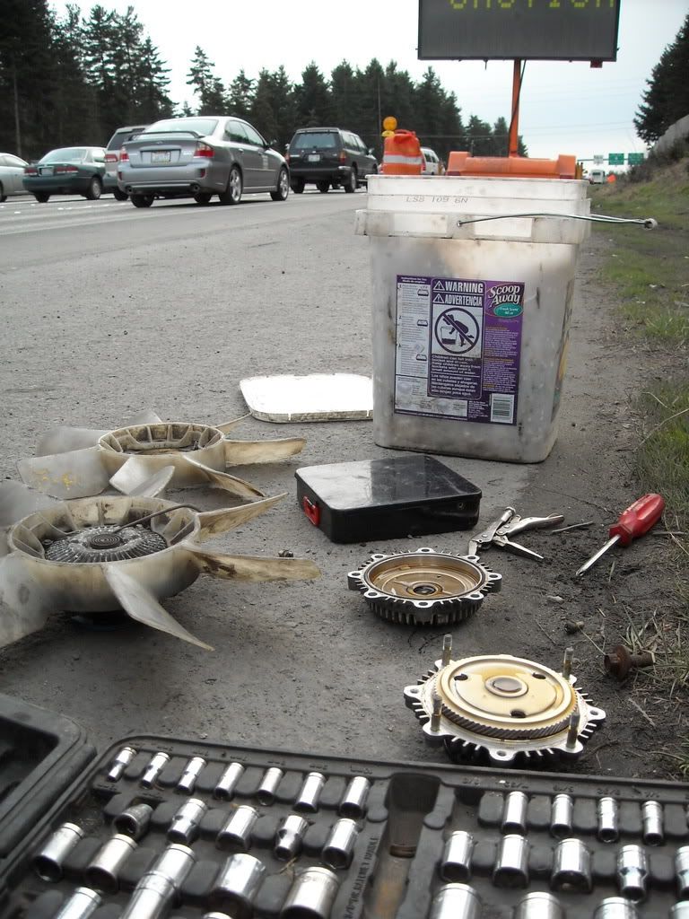

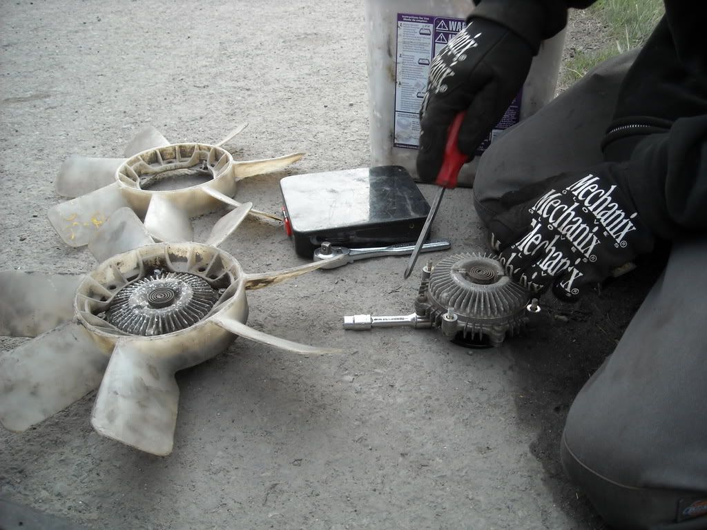

ripped the fan off
dismantled it

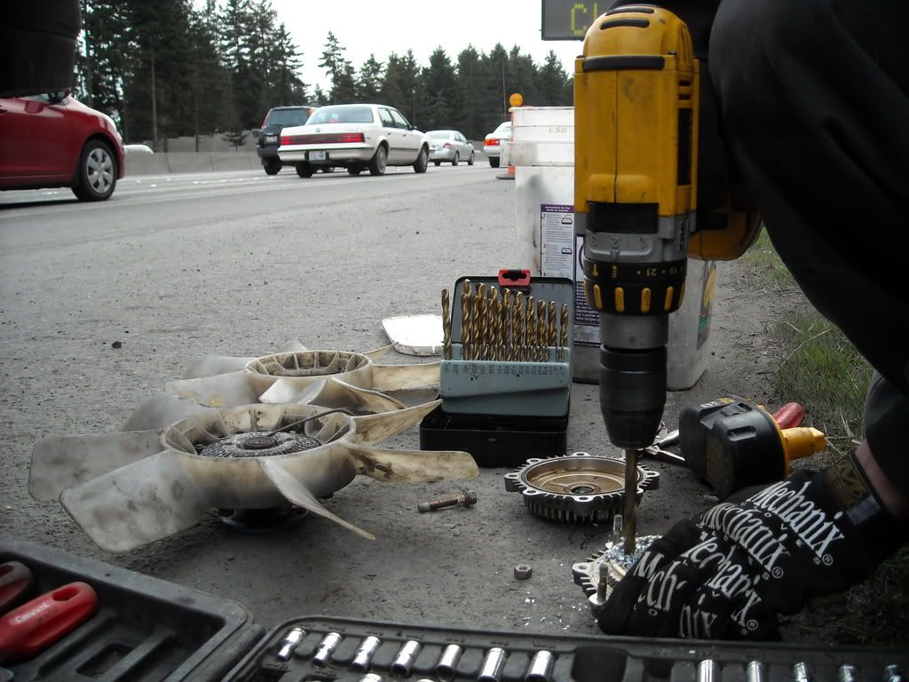

now drill a hole through one of the holes on the flywheel

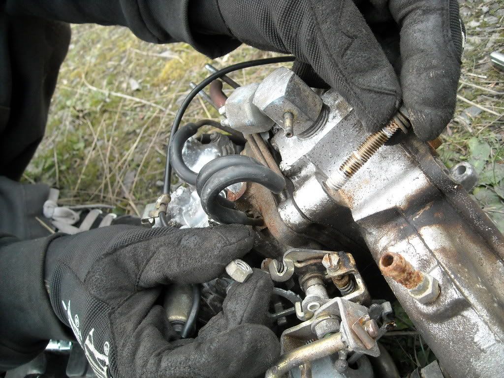

if you really had to you could steal the nut on the EGR valve intake mount and this bolt from the carb.
use the nut from the EGR to space the bolt from the carb, tighten the shit out of it.
remove the studs
use 4 fender bolts to bolt the fan to the locked fan clutch
bolt the F'er on
drive it home
