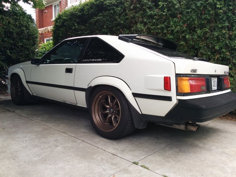

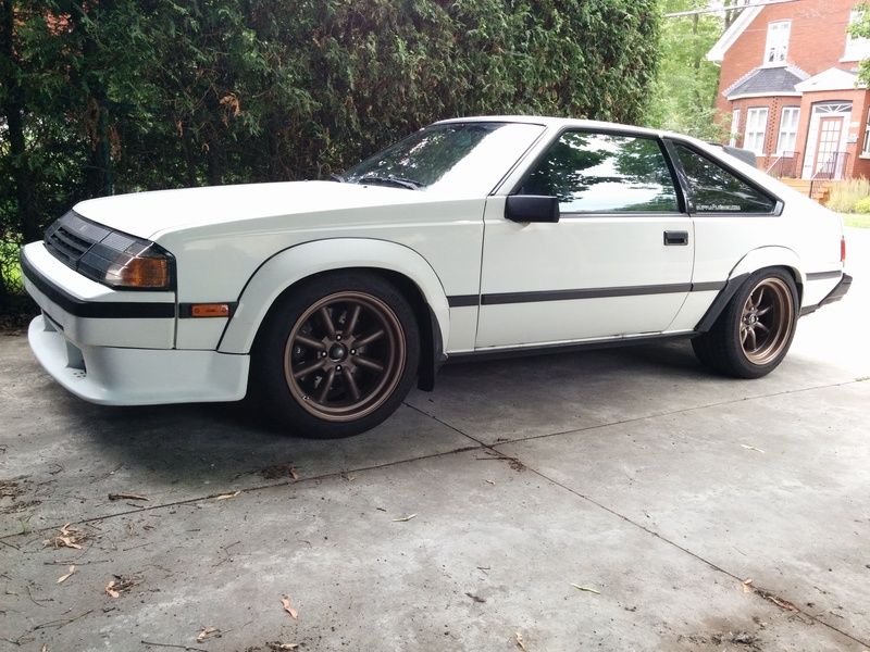

Just installed my latest aquisitions.
Spec
Front 17x8.5 0. Offset
235/45R17
Rear 17x9.5 0offset
255/45R17
Slight rub in the back when I hit big bumps
Will be installing longuer lower arm in the front so I might have to roll the fenders and grind the air damn (Kaminary).
I think the front would look better with 225/40's instead and more drop.
I'm running the old sets with awesome NT-01 which grip like tomorow. I needed a street set
