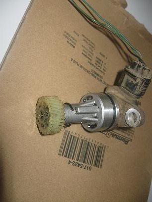

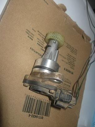

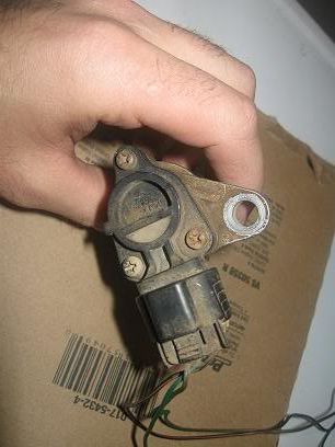

For those of you who want to add an electonic speedometer to your ride, one part of it will be easier thanks to this handy piece of information
Some toyota pickups (with w series transmissions) had electric speedos stock, and the sender will fit in your wXX transmission because its basically the same part only with a 3 wire magnetic sensor instead of a cable drive.
I pulled this speed sensor and the cluster from a 92 2wd shortbed base model (not sure what other models had em), doesnt even matter if the plastic gear corresponds to the rear-end, cause electric speedos (aftermarket anyways) are programmable

92+ 2wds and some 4wds :D
