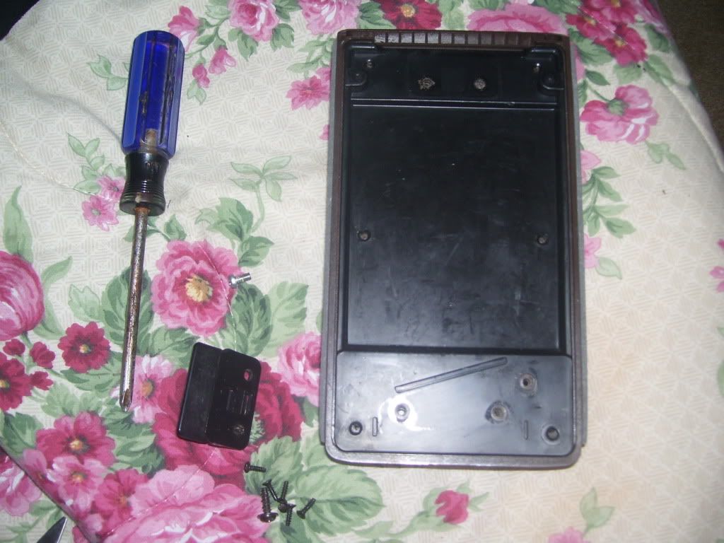

So, first you need to remove the latch, and all of the other screws. Be sure to use a tiny phillips head, you round the "teeth" off of the inside of the screw head, and you're pretty much "screwed". :lol:

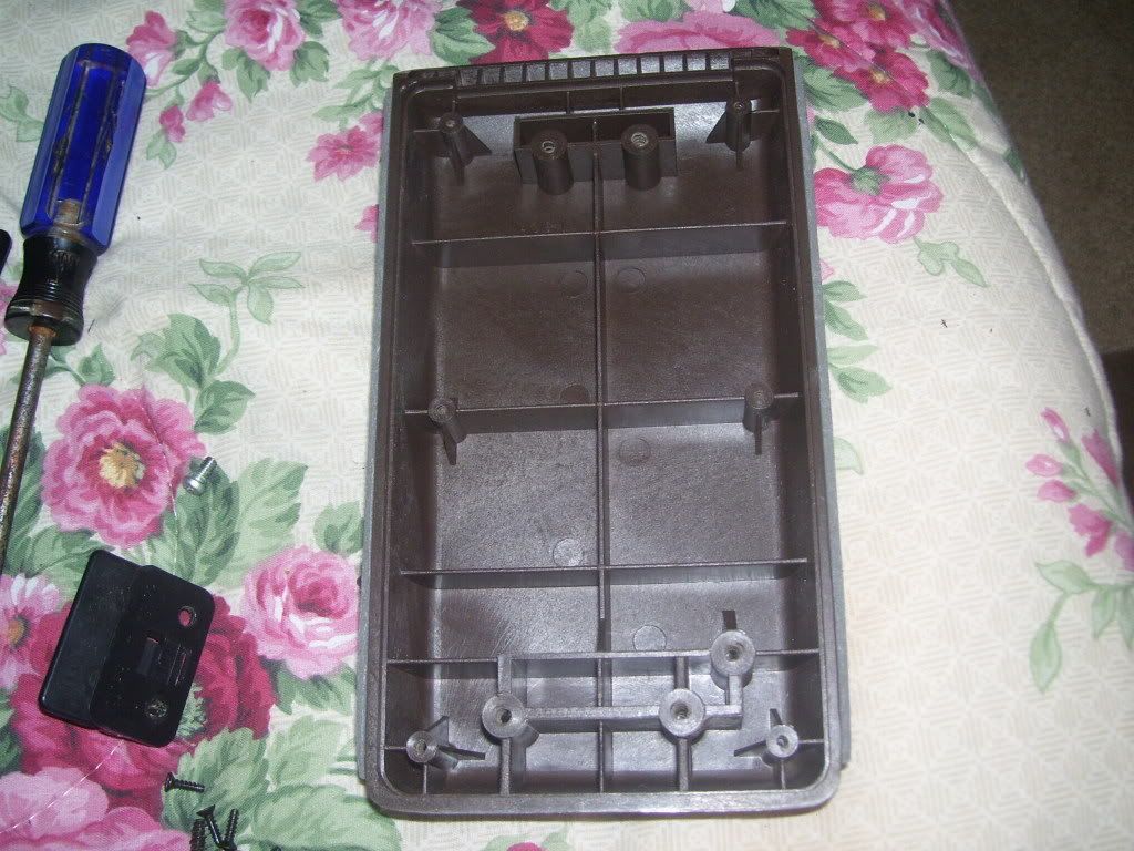

The bottom with the lid piece removed. This was a black armrest, so I'm not sure why the plastic is brown. Oh well.
Remove the top rubber piece.

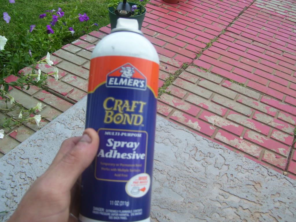

Break out your weapon.
Spray moderately. Too much, and your fabric will turn white, and be hard in that area. Too little, and when you put your arm on it, it's going to release.

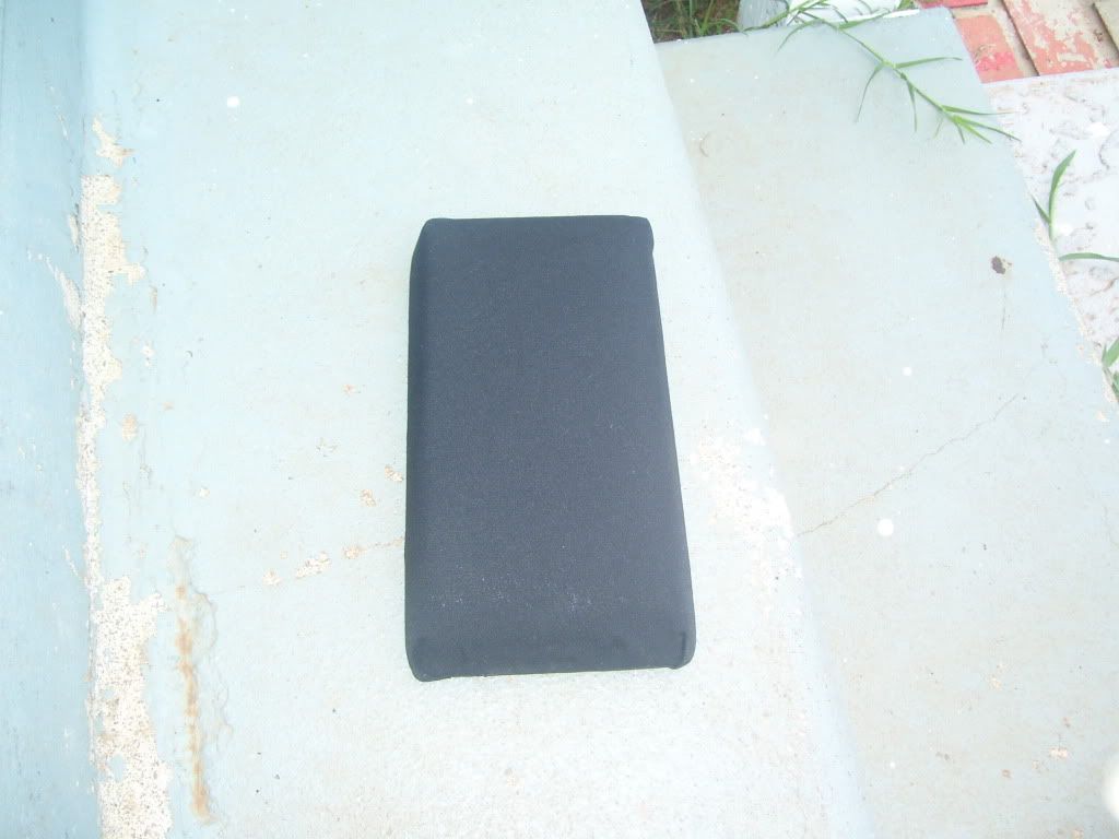

The finish.

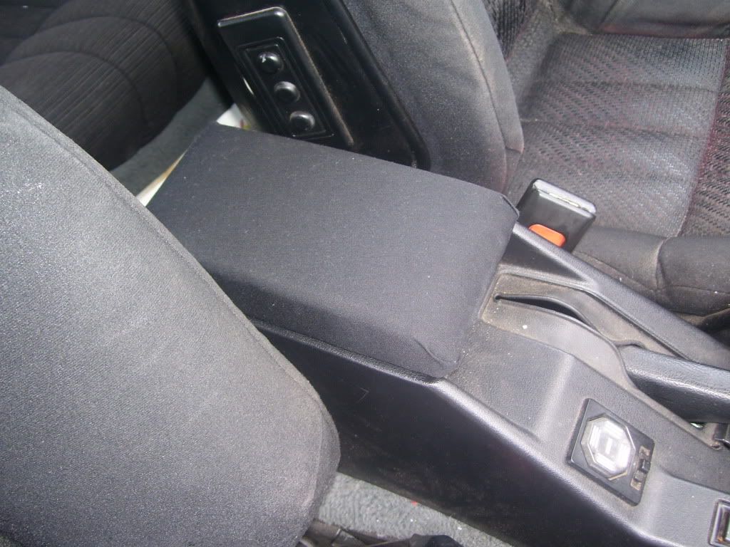

Installed:

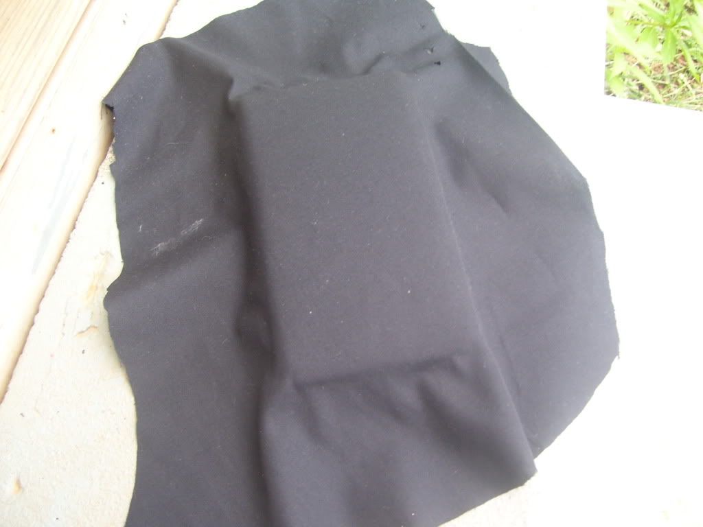

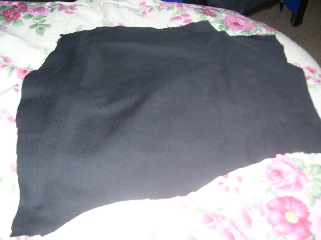

Material used:
You can get it at walmart. $3.00 and something a yard. I bought 4 yards, and came out a little over $13.00. You can also buy vinyl in your color of choosing for $7.00 and something a yard.
