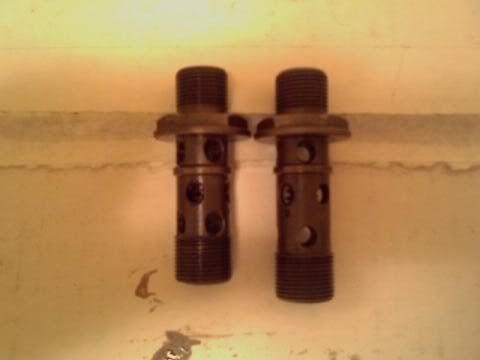

Corax: What year is that from?
  • Posts: 9,918
Re: Nothing pretty build thread
« Reply #58 on: Jun 02, 2013, 09:12:23 am »
Okay, that's what I thought, but it looks like it'd be thicker then the length of 2xR oil filter threads.
Offline corax
  • Posts: 1,468
« Reply #59 on: Jun 02, 2013, 03:54:45 pm »
IIRC, it came off a 2UZ engine, early to mid 2000's Lexus LX
It is.  The threaded tube thing that the oil filter screws onto is removed from the engine block and there is a much longer one that goes through the oil cooler to bolt it down.  The pic below is of a Honda part, but looks about the same
