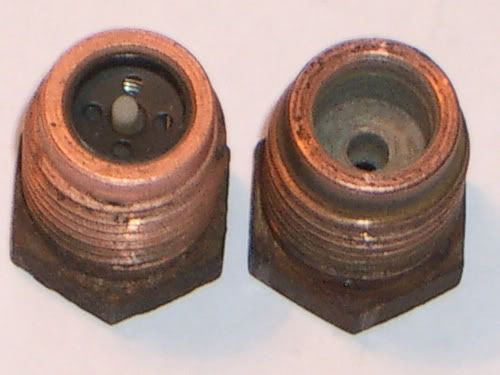

The valve is contained in a threaded piece that goes into the mc and the brake line attaches to. Here is the difference between an outlet with a valve on the left, and one without on the right. This is a view from the "inside" btw. Note: these pics are from a Landcruiser MC so might be different from what you see on a Celica MC, they are not pics of the P/N listed below.
These outlets have their own part numbers. I believe the distinction is with res valve and w/o res valve but I havent seen pics to confirm this

So, if you need to replace your master cylinder: Check the rear outlet! If necessary take the outlet off of your old MC so that your brakes will function properly.
Rear Disc= No valve
Rear Drum= Yes valve
If you have rear disc and the valve is left in, your rear brakes will drag, causing unnecessary wear on brake parts and reducing mileage
If you have rear drums and the valve is not in place you will be making the front brakes do all the work and wear them out prematurely...
