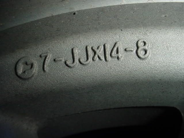

Explain the factory info (use my pic if you'd like), and chop the rest of what you explained into one huge post about offset vs backspace and width, with the pictures you have, and if they can't figure it out, they can ask specific questions or just get screwed with poor fitting wheels. We can't hold their hand and take them to buy wheels.
