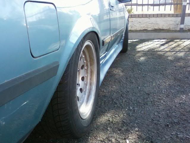

« Reply #50 on: Dec 11, 2009, 07:56:29 pm »
14x7+10ish and yeah a little bit of rolling was necessary for my ride height

« Reply #51 on: Dec 11, 2009, 08:05:35 pm »
what are those weld racing wheels?
