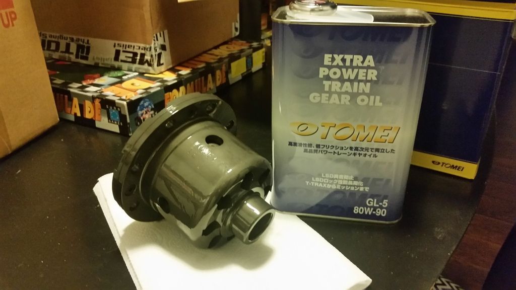

Soooo, after some pretty hard drifting shenanigans in the rain on Saturday night, my open diff started making some funny noises that progressively got louder as I increased speed :heh:.... I knew it was on it's way out, I mean, one tooth from a spider gear came out with the drain magnet on my last fluid change, but I drove it like that this whole last year with no issues. Now it's not happy at all, I am willing to bet a couple more teeth are chilling on the drain magnet lol! Hey, I drove it to work today, thing is for how long? But of course I planned for this, I have a low mile complete differential carrier on the side with a R&P still in beautiful shape, and this is what is going to reside in it in the next week or so:
The Tomei 1.5 way LSD for a zenki AE86 is already on the way, along with a bearing kit and solid pinion spacer from Weir.

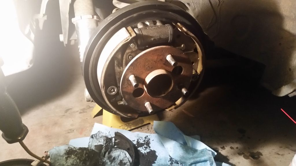

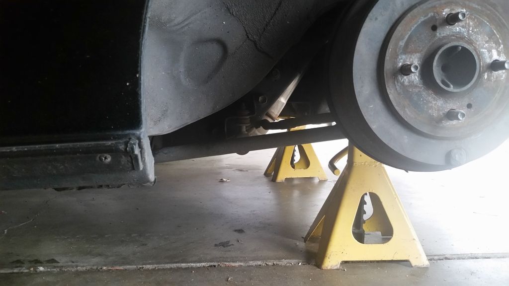

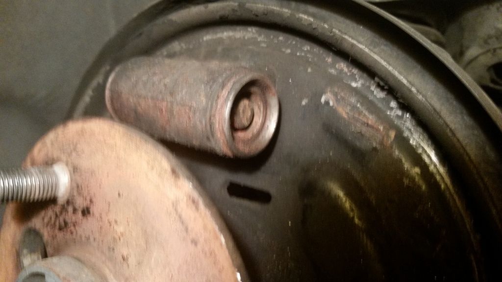

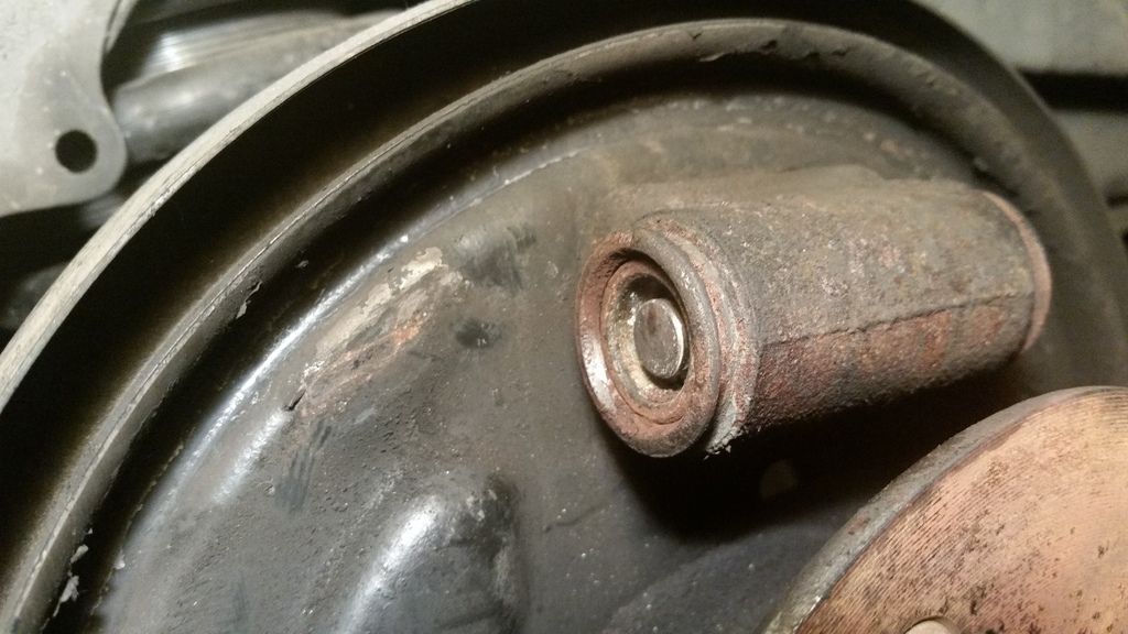

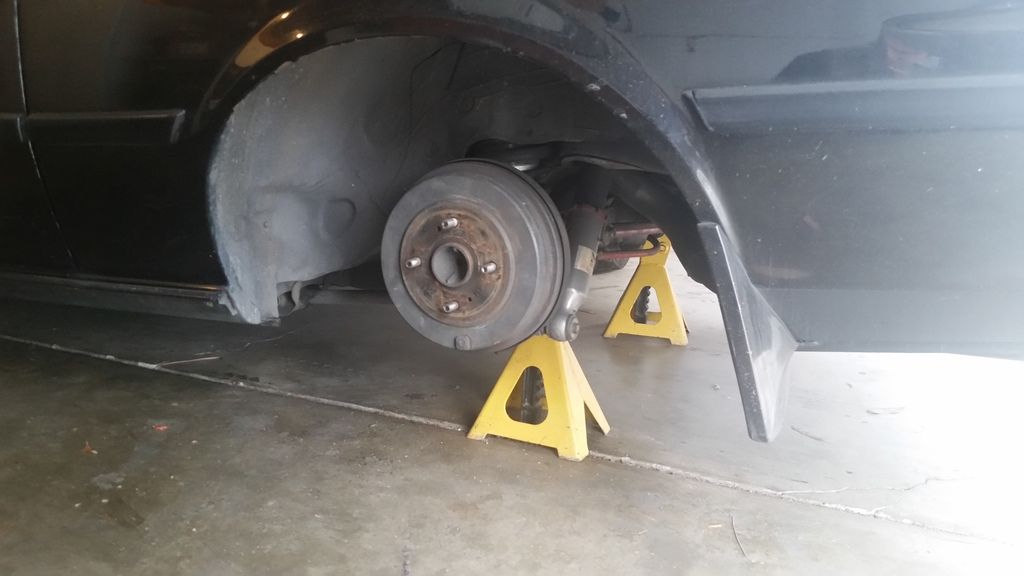

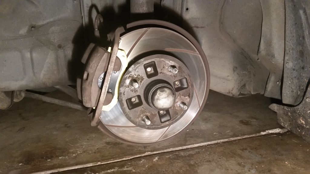

Here is the update from last weekend, ended up doing a brake job on the car because I was having issues with the fronts locking too easy for quite a while.
A guy I know in Eugene is currently making traction brackets for me to remedy this issue. (Thanks Brad if you see this)

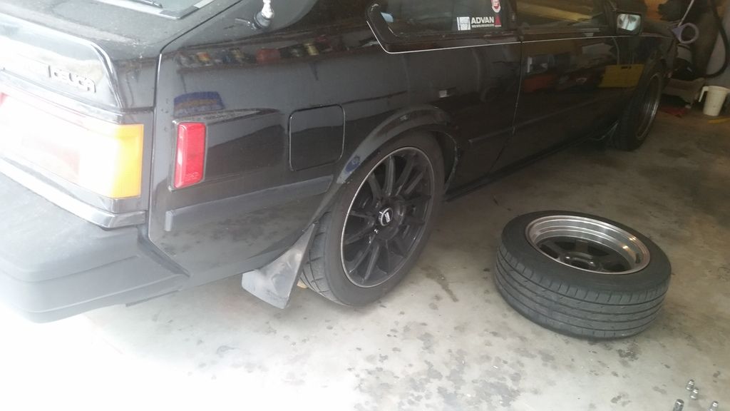

My buddy stole my wheels to see the difference between his 30lb 17x7.5 wheels with 225/45s RS-3s  and my lightweight 15's with crummy dunlops. Needless to say his P10 G20 picked up a whole lot quicker, and surprisingly fit my 15x8 0 offset because of the amount of rolling he did to get the 225's to clear on his G20, not an easy feat.
lol.
:yuck:

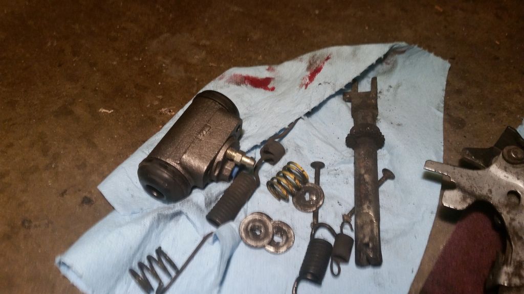

Well there's my issue. Both sides, the wheel cylinders were seized. Surprising since I rebuilt them 3 years ago.
New hotness.
Oh hello EBC Yellowstuff pads
Yeah, I was a lazy ass and didn't get new rotors, didn't feel like setting wheel bearings. I'll slowly seat the pads in the next 1000 miles to make sure they mate flat to the rotor before I actually burn em in.
And then I bled the car with Motul RBF650, and woahhhh, even before initial bedding in, the brakes feel AMAZING, like holy shit how did I drive the car so long with it how it was, it was ridiculous. And after that is the story were I proceeded to go drifting in the rain for fun and fuck up my differential.

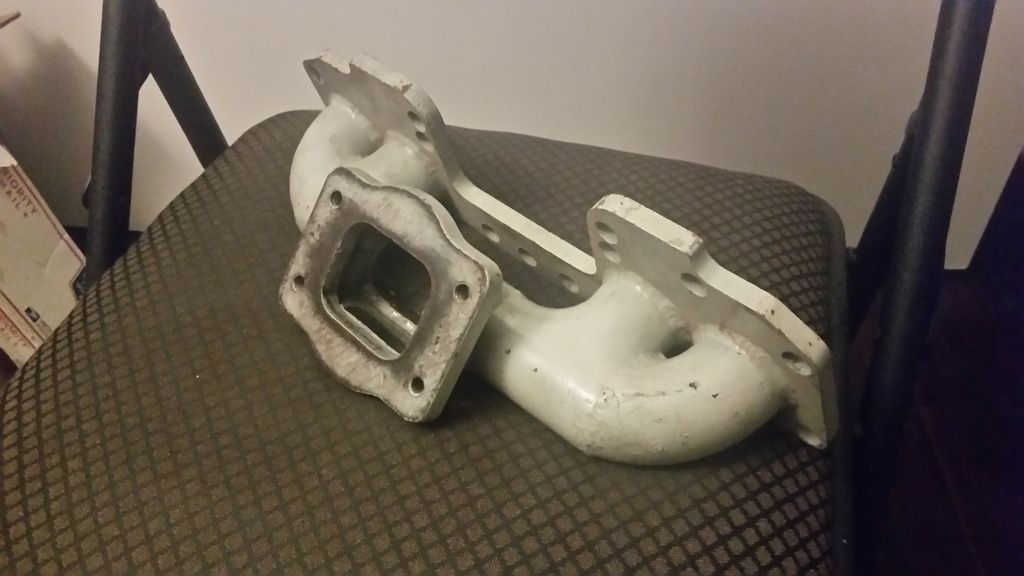

Manifold is based off the diy template on the truck forums from what I can tell, who ever put it together had pretty nice welds and smoothed out the merges nicely. I got it for $250 and looks to have never been used.
