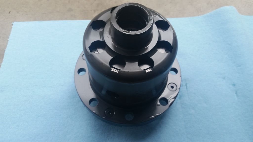

Ended up dropping off my spare diff carrier, new bearings, and the LSD at the diff shop yesterday. If you are in the Bay Area, Ty at Bay Area Differential and Gear Garage in Hayward is your man. Awesome guy who really cares about his customers, he has no problem spending time to help you understand what he does, even showing you how himself. He even went out of his way to get my differential back as soon as he can because my car is my only means of transportation, which he said would be Saturday at the latest. People like him are really rare in the automotive repair industry these days if you ask me.

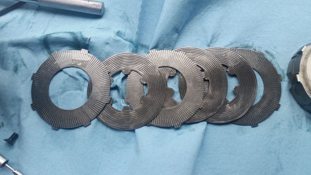

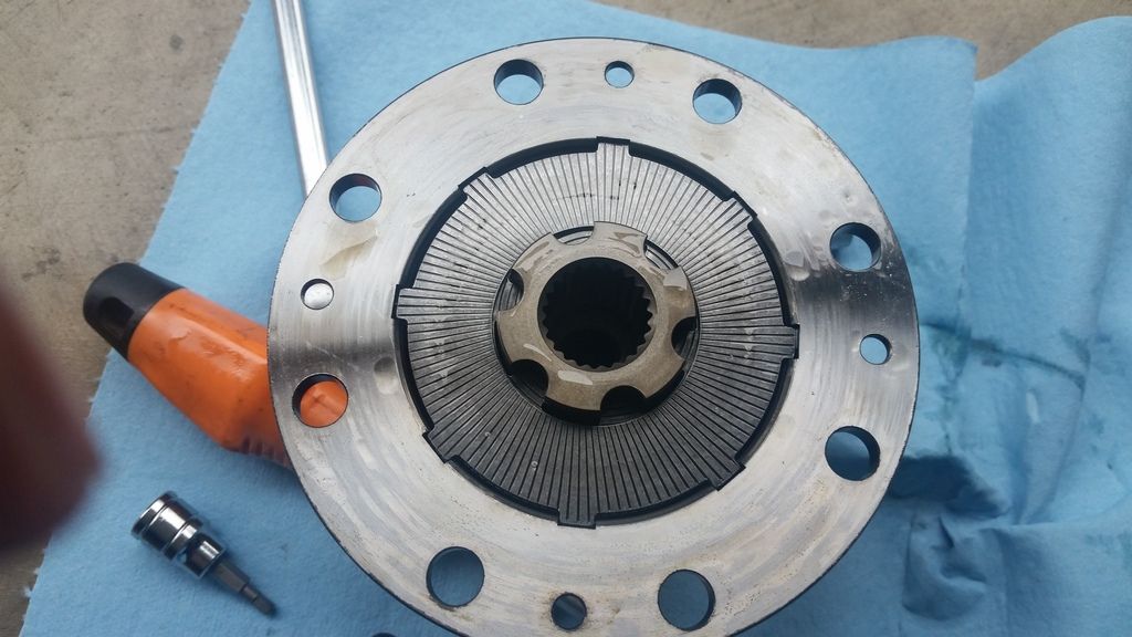

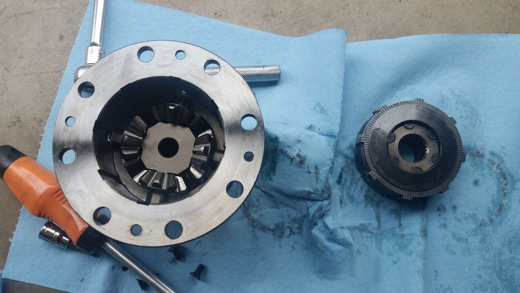

Here are some pictures of me re-arranging the clutch packs on the LSD for less lock before I took it to the shop.
There are 4 countersunk allen head screws that need to be removed in order to disassemble Kaaz/Tomei differentials
Cover off, you can see one side of the clutch packs.

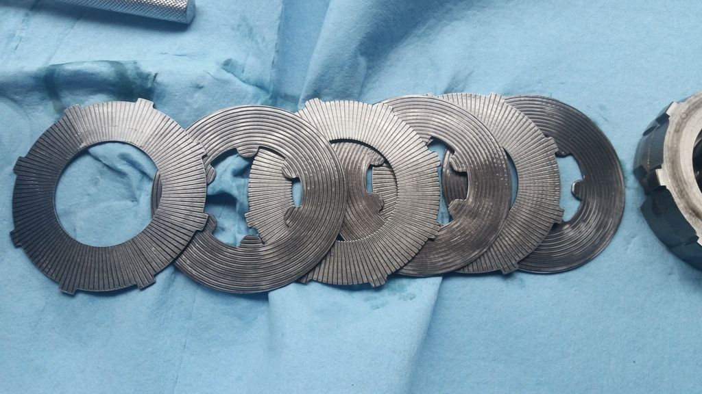

Here we see the order of how the clutch packs are arranged, 6 disks for a total of 6 friction surfaces, meaning this came 100% locked, not what I want. Arrangement order, ABABAB where AB and BA denote a friction surface.
We rearrange the disks to create less friction surfaces lowering the total lock. since there are 6 disks, we can rearrange from 6 to 4 or 2 friction surfaces. 100% lock from 6 surfaces gets us 16.7% lock per friction surface. By swapping the last 2 discs from the right, I disabled 1 clutch disk thus I now have 4 friction surfaces as seen below, so ABABBA, 4 surfaces x 16.7% = 66.8% total lock to the wheel with the least traction. This is inline with what the manual says, 4 friction surfaces is around 65% lock which is what I want. 2 would be 30-33% total lock. Along with the 1.5 cam angle, 55 degrees on accel, 20 degrees on decel, I calculated I would be at around 24% lock on decel.

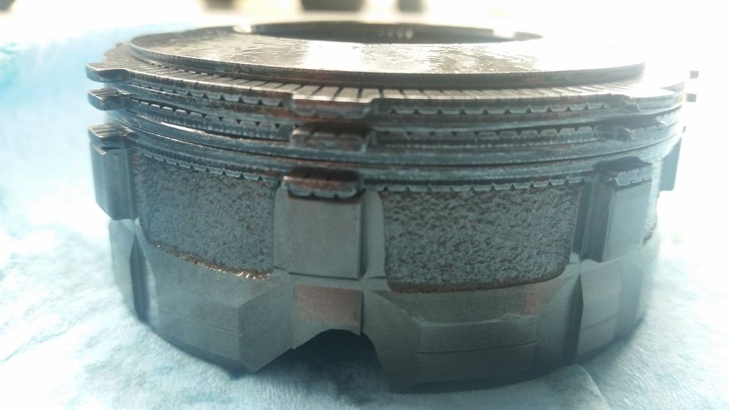

A look at the center section and stacked plates with preload ring.
And that's it, slap it back together and you are done, 100% lock is not ideal for grip driving, and with the low initial torque that this LSD has at about 40ish ft/lbs, it would pretty much act like a welded on acceleration and cause the car to be really understeery when grip driving, sure you could tune it out, but I am not solely drifting and my car does not make gobs of power so I have no reason for 100% lock on accel. My car is built as an all rounder that does everything well. Keep in mind those percentages are theoretical and vary depending on your suspension setup, how grippy your tires are, the amount of power your car makes, among other things. Keep note this clutch arrangement has to be done symmetrically on both sides.

How interesting, the clutch discs have the hoz/vert grooves to create the different friction surfaces. Never thought that was how clutch pack LSDs work! I thought it was clutch discs + spring (Eaton posi?)

Plus, this way, you won't wear out your diff prematurely. Too many guys think the roadway is a track... sayonara clutch pack. A track or drift car needs the 100% lock. Good job man. The world needs more "all arounders"
Also a good point haha. I was on the roof about maybe leaving it as is at 100% just to see, but I feel like it would really mess with daily drivability.

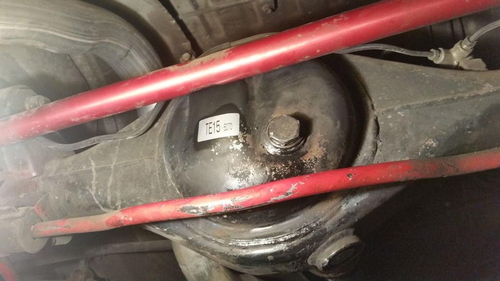

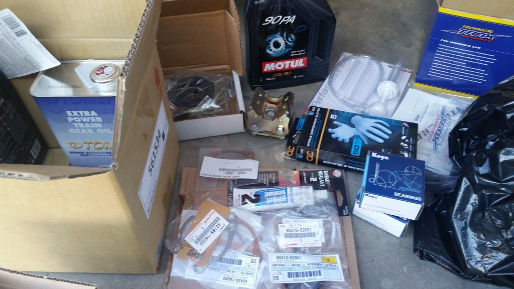

Yay, updates! Well not too new as I have just been too lazy to post because of work.

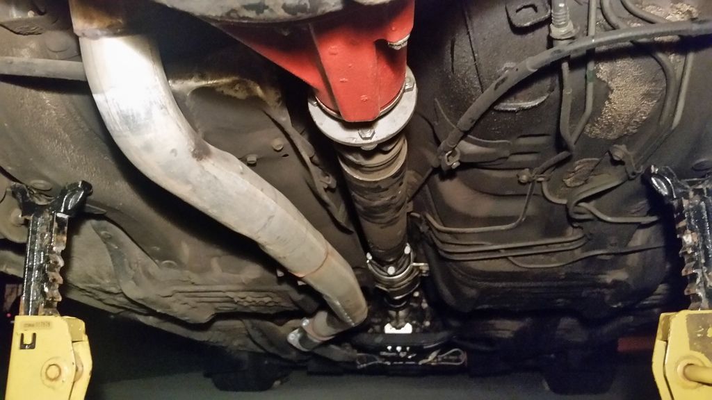

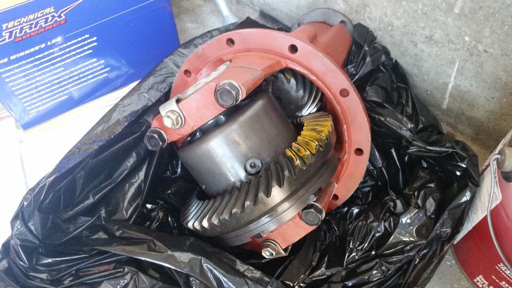

Lets continue, here is the pile of shit I bought to basically net me a brand spankin new rear end, albeit the differential included, ended up being a grand total of $1315 after labor and such. Every new OEM seal for the rear end, koyo bearings all around, and new center support among other things. Most of ya are probably like why the hell did you spend that much on a T series rear end. Well, because I can lol. It's lighter than any other option, I don't mind drums (constructing rear disk setup eventually), and it will take the abuse I will put through it.

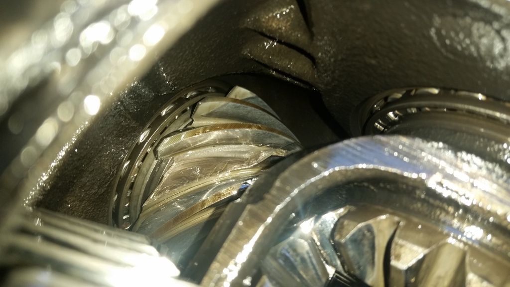

Yay, tight, fresh, and will take a beating, just how I like it :spiteful: The pattern came out great, new bearings, and a solid pinion spacer from Weir. Don't mind the color, dude ran out of black paint and I told him to spray it with whatever he had haha.

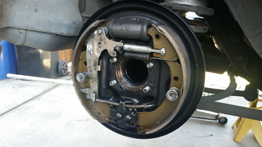

Popped the axles out and dropped them off to my buds shop to get the new bearings and races pressed on.

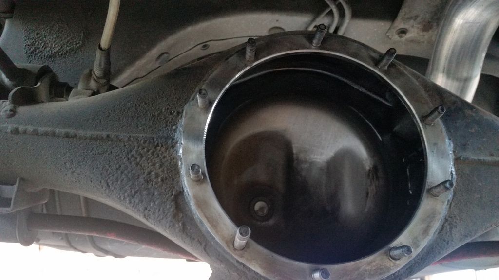

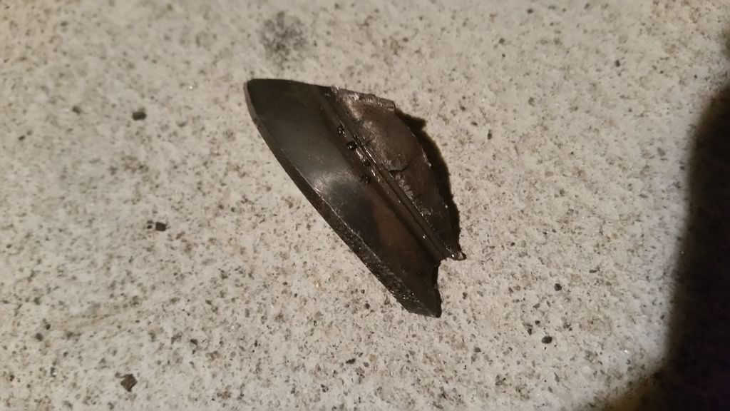

Dropped out my old 320k mile differential and cleaned the housing and gasket surfaces.

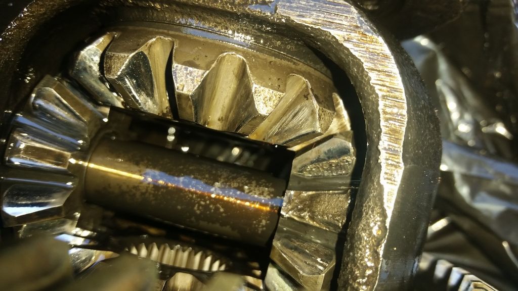

And here's the source of my horrid noise. LOL. It's not that bad.
Whoops.
And after some picture magic, everything is back together! Axles do not need to be trimmed on aftermarket LSDs.
Put the LSD sticker on the housing that came with the diff, makes the car have 5 more horsepowerzz

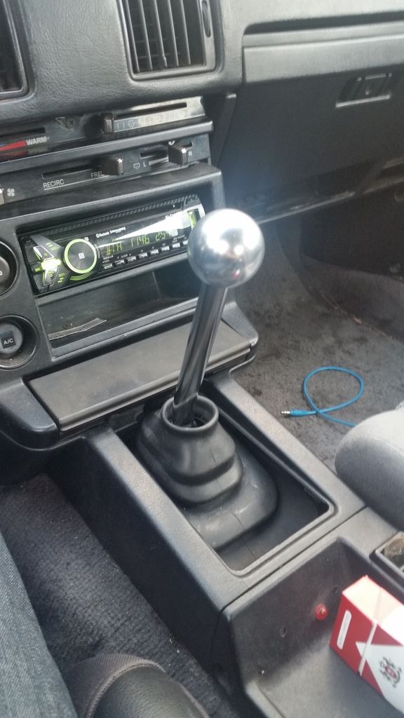

Well for an end note, I ended up getting the Cube Speed short shifter from AUS, pretty neat, and good craftsmanship, installed it yesterday, drove with it today. Verdict: good buy, crisp shifts, really really short throw, like 2 inches of throw between 1-2 and so forth. That and it looks bad ass. Only grip about it is that it sits a little further forward that the stock shifter, but it's not so bad once you get used to it, just have to stretch your arm further than you normally would and my bucket seat doesn't help it's case at all either lol.

Not that bad? Those spiders look like they're ready to strip off completely at any moment!
Sarcasm is hard to display over text :rofl: I am lucky it didn't seize and send me into a wall on the one day I drove it like that.

Yea the cube shifter is great. of the bestmods ive done and yea when i shift into 3rd it sometimes hits the ash tray bt i plan on heating it and bending it slightly beyond that its great. It is noisy and the first couple of days its hard to row though the gears bt now after 2months it gotten smoother and shifts awesome!
