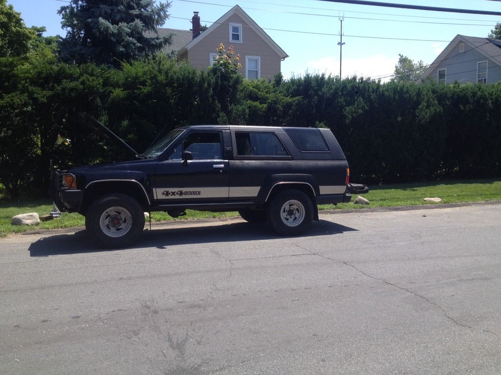

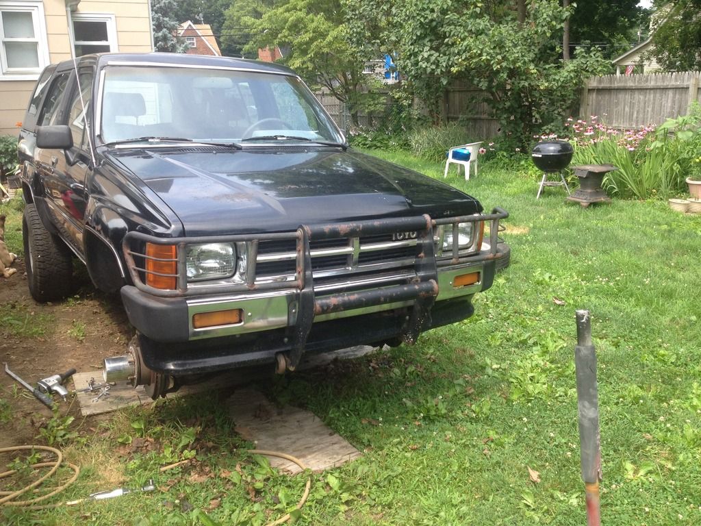

I woke up Saturday morning and hammer had a 88 4runner parked on my front lawn with for sale signs in it. I just had to have it so we struck up a deal. He said If I swapped the front diff and rear axle into his truck and installed the front end kit he bought for his truck I could have it. His front diff is perfect and the rear I think has a leaky pinion seal and axle seal. Should be easy to fix and it will be out already making it easier to work on.

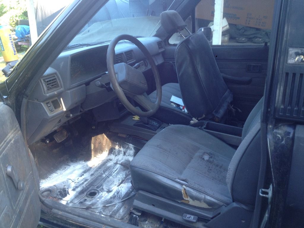

The truck is an 1988 22re automatic with 118k. The rear window was stuck down for a few years and mold and animals were inside it. There is no carpet which is probably better anyway for me. The floors are in great shape no holes the frame is in perfect shape as well. Dash is not the greatest seats are a little ripped but the foam is still all good. door panels and headliner are all moldy. The body has a little rot and the paint is fair at best.
I did a little research looked at some pictures of trucks and I think my game plan here is to stuff a 2 inch ball joint lift up front and 4 inch blocks out back. Hammer might have both of those items and said I could have them so quick easy small lift. I would like to stick 35 inch tires on it after that and cut the fenders a little bigger which as a bonus i can also get rid of the rust in them that way. I am going to have to have a quick look at hammers rear before I stick it under my truck and fix what is leaking on it. I am also strongly considering sticking a locker in the rear end while I am at it. also that ugly useless pushbar has to go! At the moment this is the basic plan.
The first thing I did to the truck was figure out why the rear window wouldn't go up. Alittle digging and I found out there is a button that tells the window controller if the top is on or off. If the top is off and the button isn't pushed the window wont go up. I guess so you don't break it. Whatever is supposed to push the button isn't there so I rigged something up to push it in, Ill fix it more properly when I take the top off for the first time. Anyway that got the window working and a little lube got it working decent. I want to do everything for hammer before  really bother doing anything else to the truck so I am leaving it stinky and moldy until I finish that stuff. I did throw a little baking soda around the inside to maybe soak up some of the smells. Then today I decided to start on the axle swap. Started a little later than I wanted but I managed to get the front diff and rear end out. I cleaned the front diff as well. Going to throw a little paint on hammers diffs.
you should have seen this thing before! the engine leaks oil somewhere, I honestly haven't looked at that yet could just be a valve cover gasket for all i know.

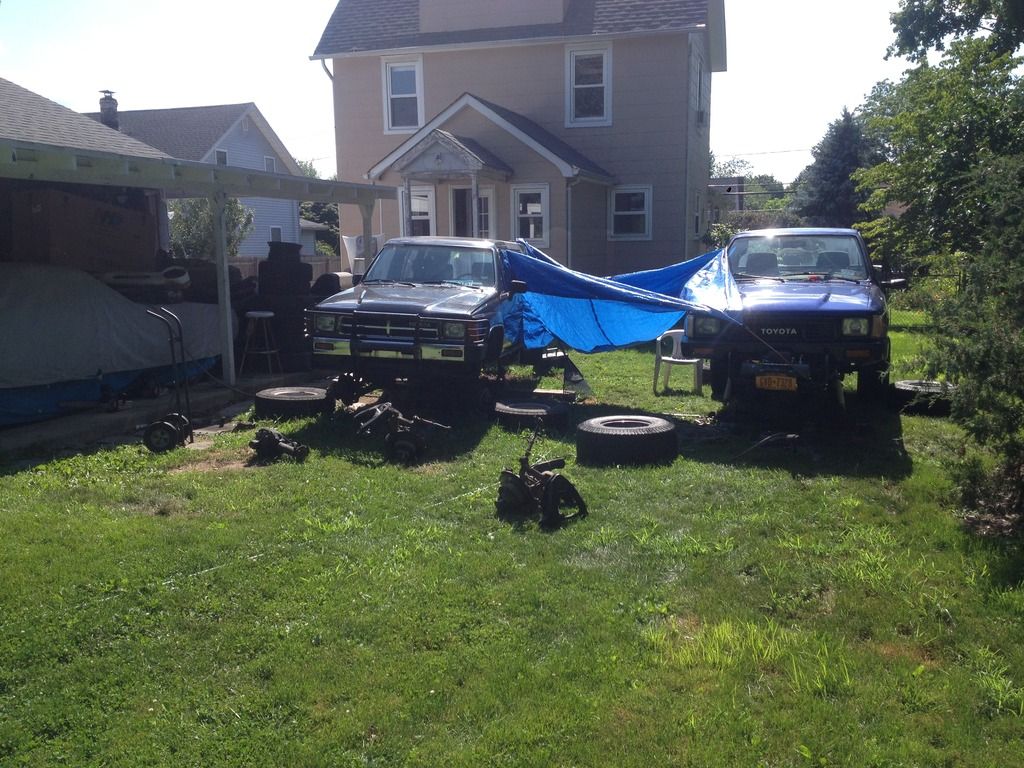

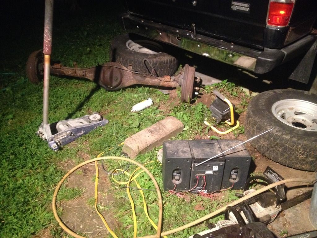

Rear end out at around 10:30 pm, I hope the neighbors didn't mind me using the impact gun.... :heh:

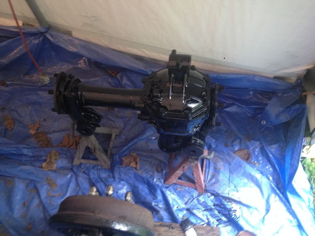

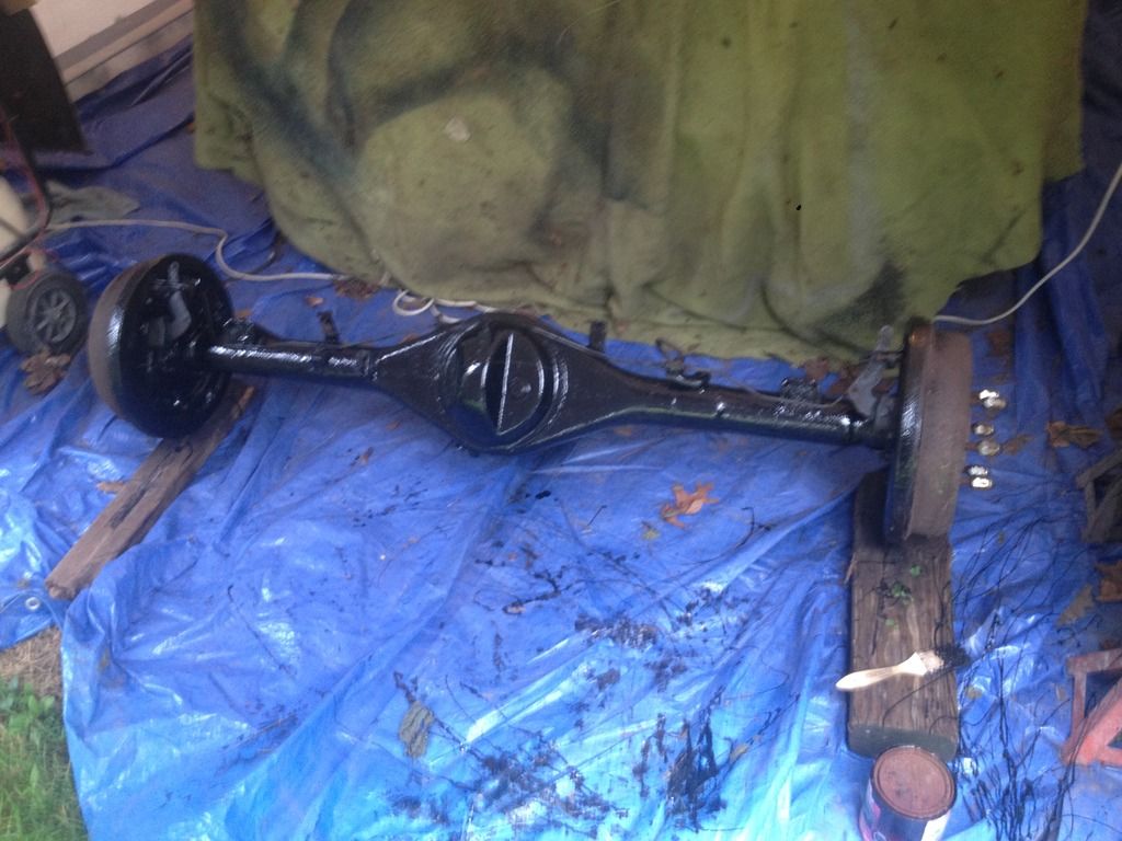

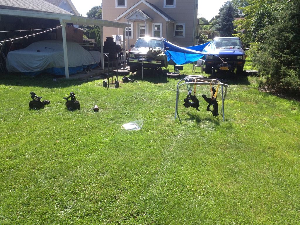

I painted up hammers front diff and rear end. I don't know if I should even bother painting mine.

So I found out the differential from my truck leaks out the pinion seal. It was a little wet on the bottom, I couldn't tell if that was from the engine leaking oil or not when i first took it out. MY guess is that the oil when sitting only partially covers the seal so half of it dried out and cracked. Anyway I ordered 2 new seals since I know his needs one as well. Ill stick the seal in over the weekend at some point and replace the broken line on the rear as well. He doesn't want to give up his truck until sunday because he wants to go fishing this weekend. I can't argue with that I would like to catch some fish this weekend. :heh:

so hammer finally dropped his truck off tonight so I can start swapping. The seals showed up finally too. Started working at like 7:30 got the truck up on stands and popped the wheel off. Went and got a brake line for the rear, put it on and had to replace the one clamp that rotted away. I had some harbor freight clamps but of course the hole was too small. Started drilling it out and my stupidity got the best of me and i slicked my finger open. oops.... it was bleeding pretty good but i wrapped it up and kept working got that god damn clamp on the brake line. I was hoping to do a little more but a thunderstorm went through so i called it a night.

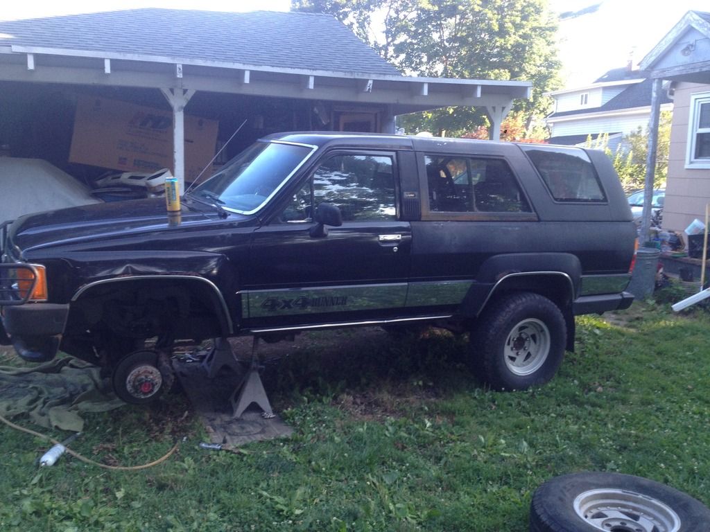

Didn't get as much accomplished as I wanted today  :disgust: Anyway I took everything off the rear except the u bolts. The u bolts are maybe 6 months old so we figured they would be re usable. Went to take it off and the nut just doesn't want to come off easily. I could get them off with a big breaker bar but it would take me a few hours but they could potentially be weakened. The safe bet is new U bolts. The crappy part is I only have 1 set of big stands to use on this truck so I had to put the wheels back on and put it back on the ground instead of taking the rear out and feeling like i accomplished something.  :heh: The new U bolts will be a few days to get so no sense cutting them off yet.
I did snag a video of the loose pinion flange. Its so loose that the nut would have backed off if it wasn't staked. Ill have to see if its worn bearings or a failed crush sleeve. I'm thinking crush sleeve since it didn't make any noise that I noticed. Its been like this for quite some time!
https://youtu.be/KnYqj5lqA_A

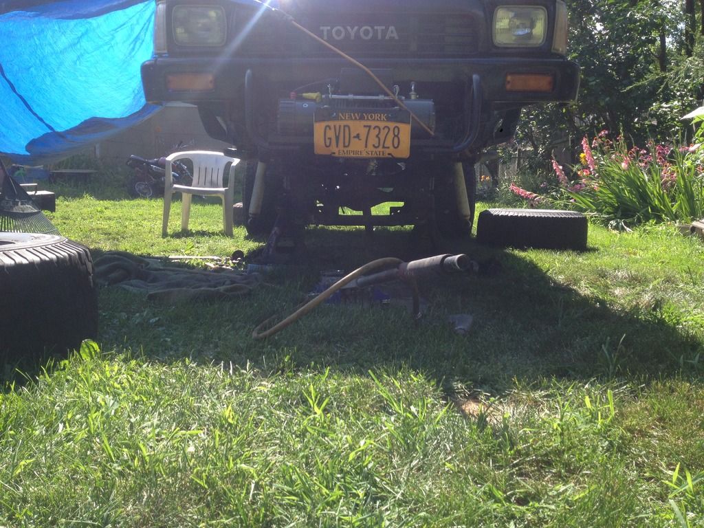

So anyway I moved on to the front got the wheels off and put it up on the stands. Then I figured let me loosen these torsion bars before I do anything else. Well I got under there and I have no idea what I am doing. so I go online and i find a website that says what to do. http://www.off-road.com/trucks-4x4/torsion-bar-adjustment-19258.html
These are what the adjusters look like.
so it says if the nut turns when you tighten it the bolt is bad? I have only tried to loosen it but the nut does turn. I put a wrench on it and turned the nut but its a real PITA to turn and i have to use a big breaker bar. Am I doing it wrong? is the bolt broken? or is it the right way but its just a bitch to do? I soaked it good in PB blaster before I came in because a storm was coming.

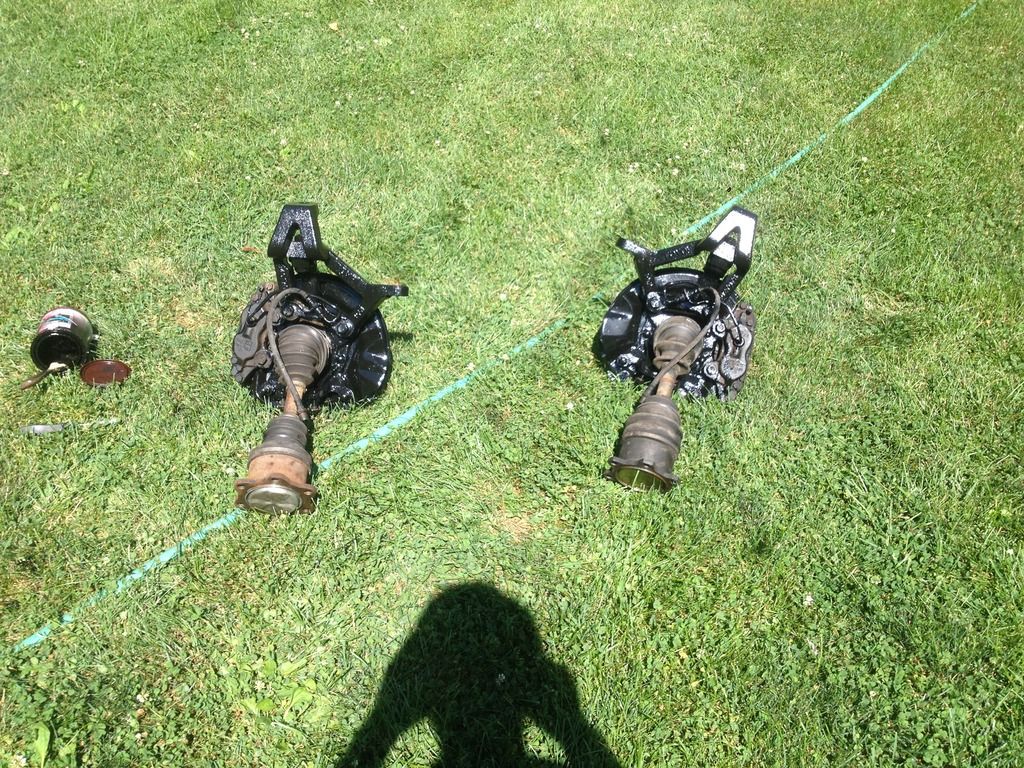

so I figured out the torsion bar bolts. just a simple nut and a bolt nothing crazy. So the first one i went to take out the impact did nothing on it so I got a huge breaker bar on it. It was such a PITA even with lots of pb it was just so corroded or something. Then I get it halfway off and it snaps in half. He said he has adjusted them recently too. Then I went to the other side broke it loose a few turns with the breaker bar and the impact worked and it came out fine. Then I had to figure out how to get them out, torsion bars aren't a new concept to me at least. Took a while on the one side until i figured out what to do. Then the other side took 5 minutes to get out! Anyway straight forward from there got both sides out dropped the front diff and put the new one in.
I just pulled everything as one unit because i figured it was easier to pop apart ball joints once they were off. so I popped the ball joints and split everything apart. Went to work on the upper control arms and managed to get the old bushings out and new ones in before I decided to call it quits.

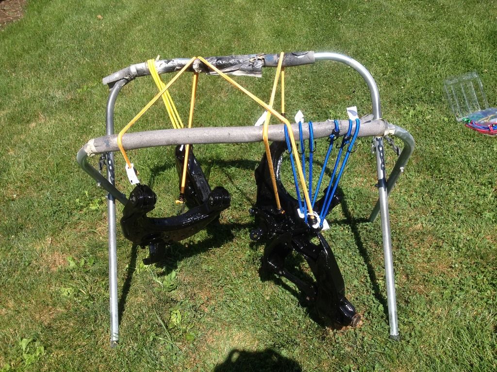

Lower control arm bushings came out and went in pretty easily once i figured out how to go about doing it. Then I cleaned everything up and slapped a coat of rustoleum on it. Let that dry and installed the upper and lower ball joints then put the upper and lower control arms in. Swapped the brake calipers with new ones and put some new pads on. ordered a couple parts for tomorrow. If everything shows up tomorrow maybe just maybe I can finish it tomorrow night.
