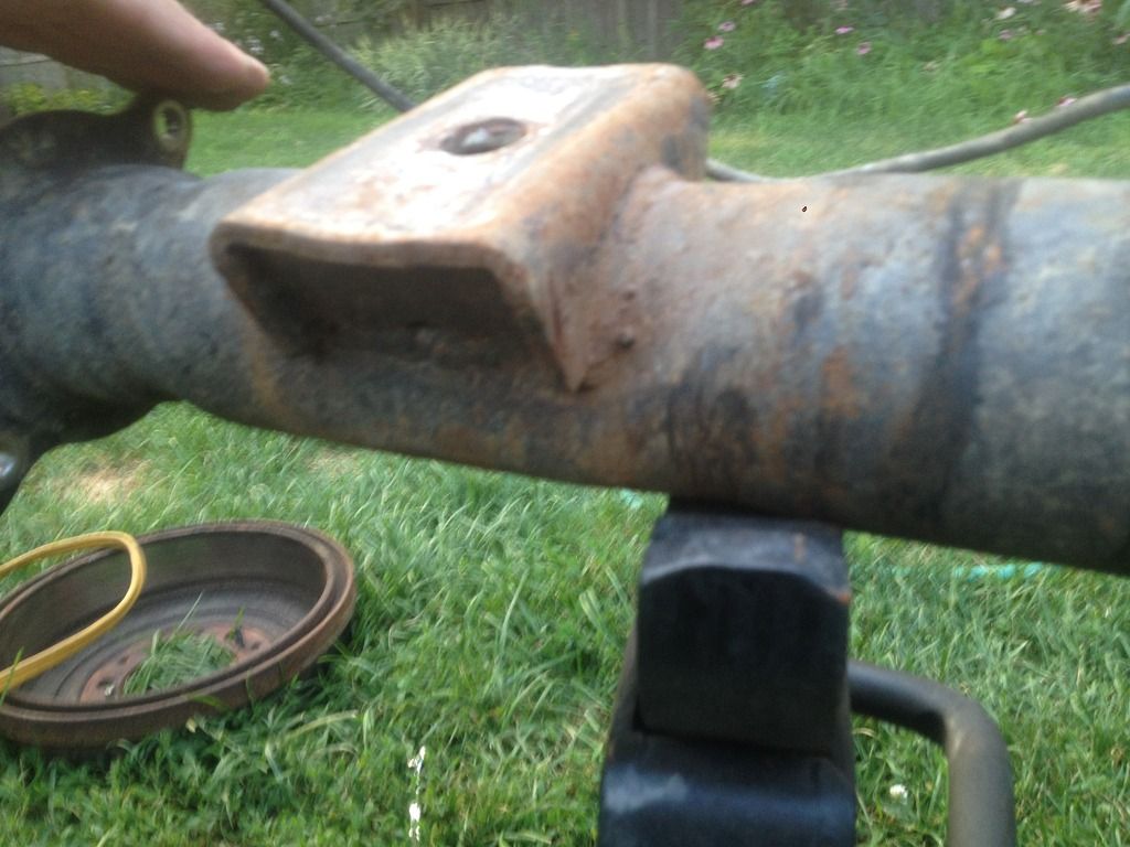

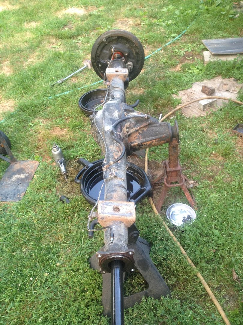

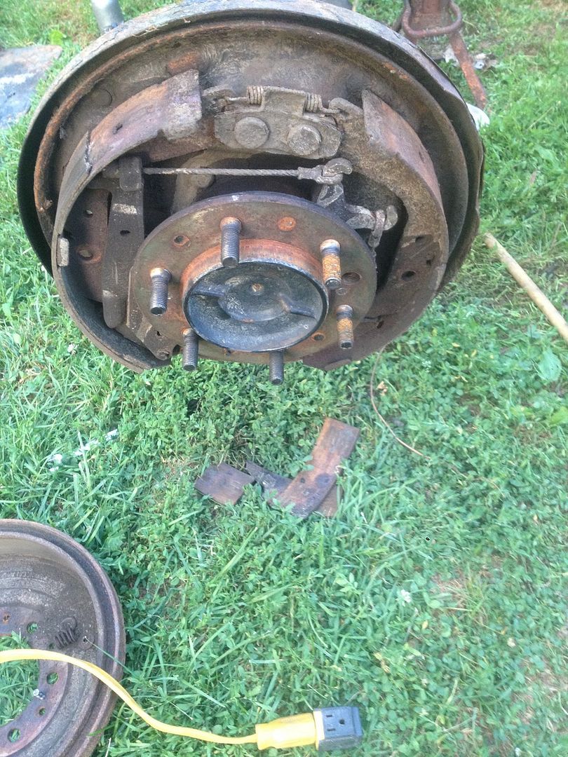

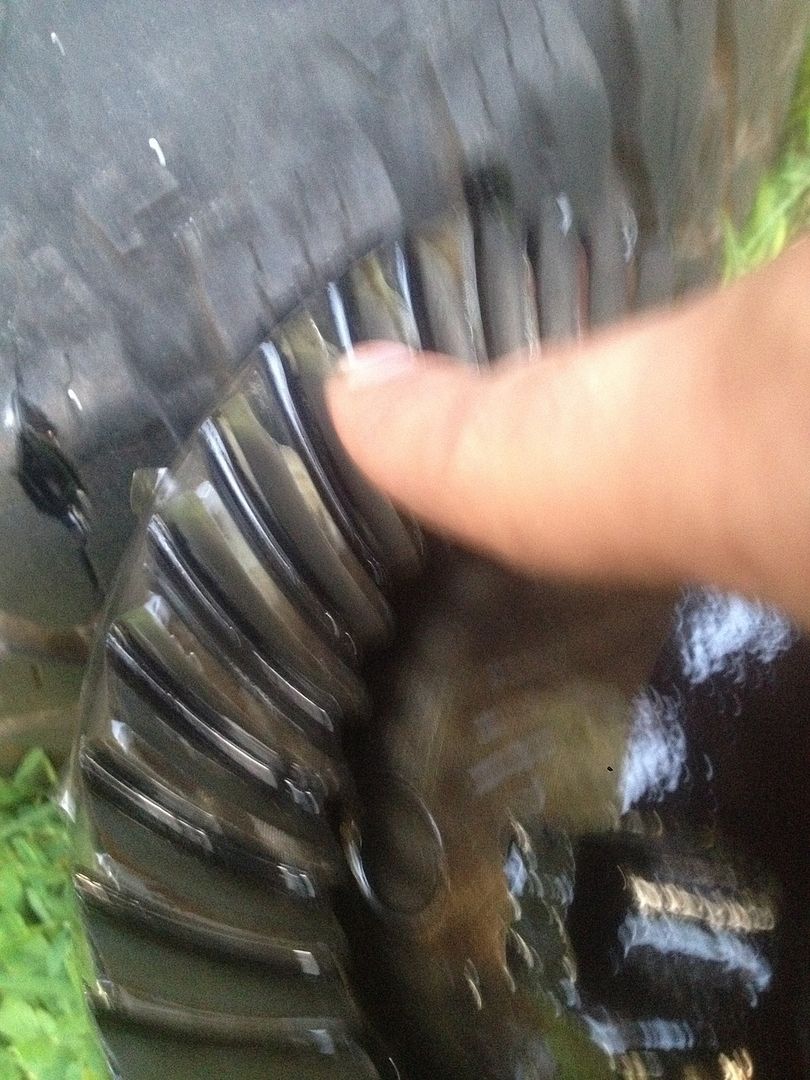

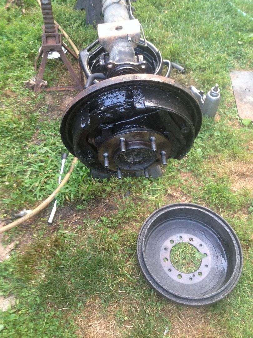

Well looks like I got fucked again. brakes are shot to shit on both sides hardware rotted on the one that didnt leak, then I'm looking at the leaf spring perches and I was like they are on different angles.... then i look more, fuck the rear end is bent! then i took the ring gear out and it has chipped teeth. not good! fuck.
rusted
well oiled
hmm these leaf spring perches don't look right
housing is crumpled here
shitty picture but i think you can see the problems....
 :crying:

I wonder if they were jumping that thing cus that axle looks bent and twisted
