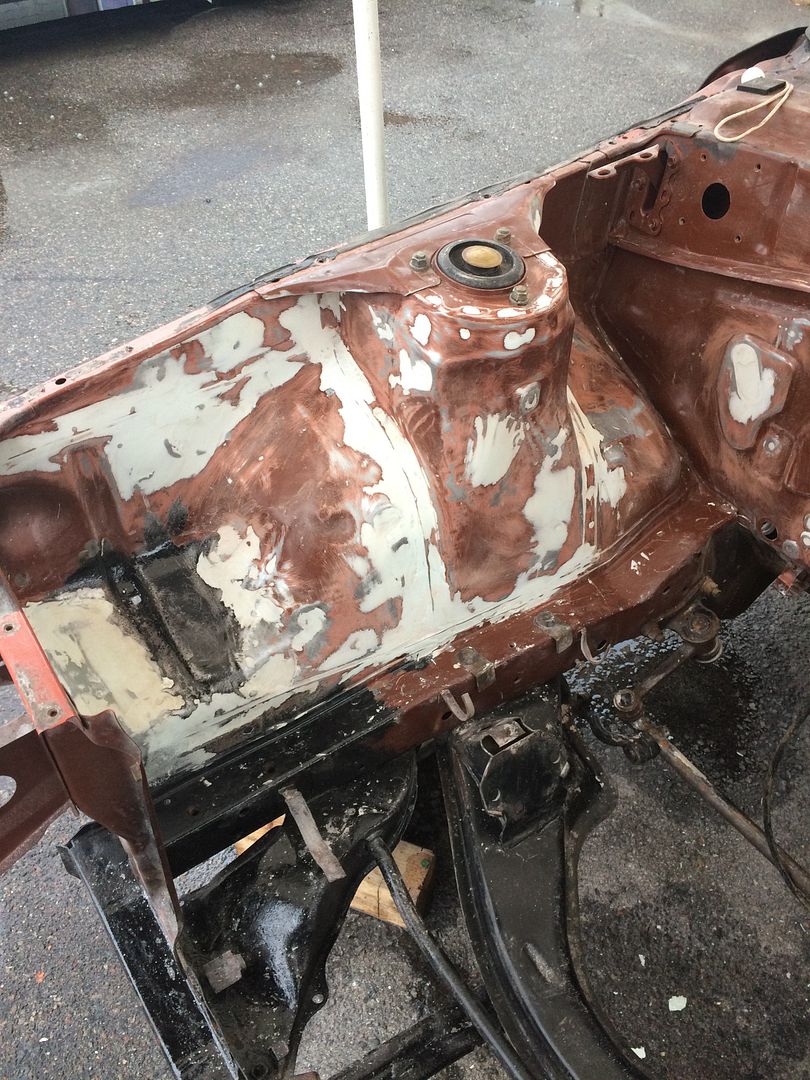

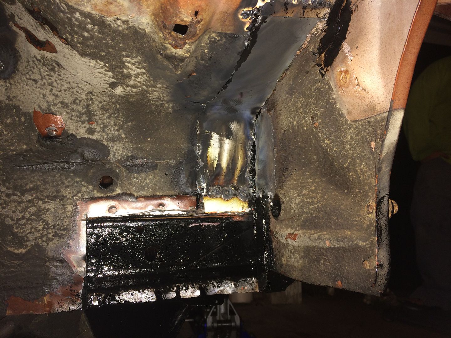

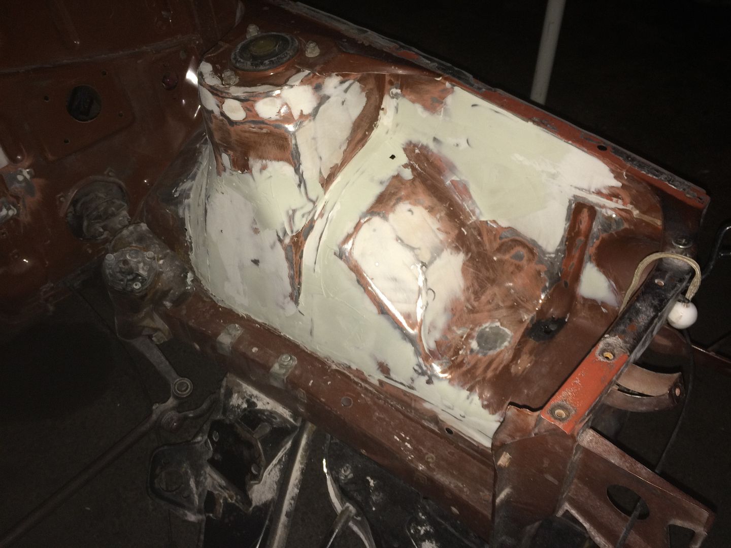

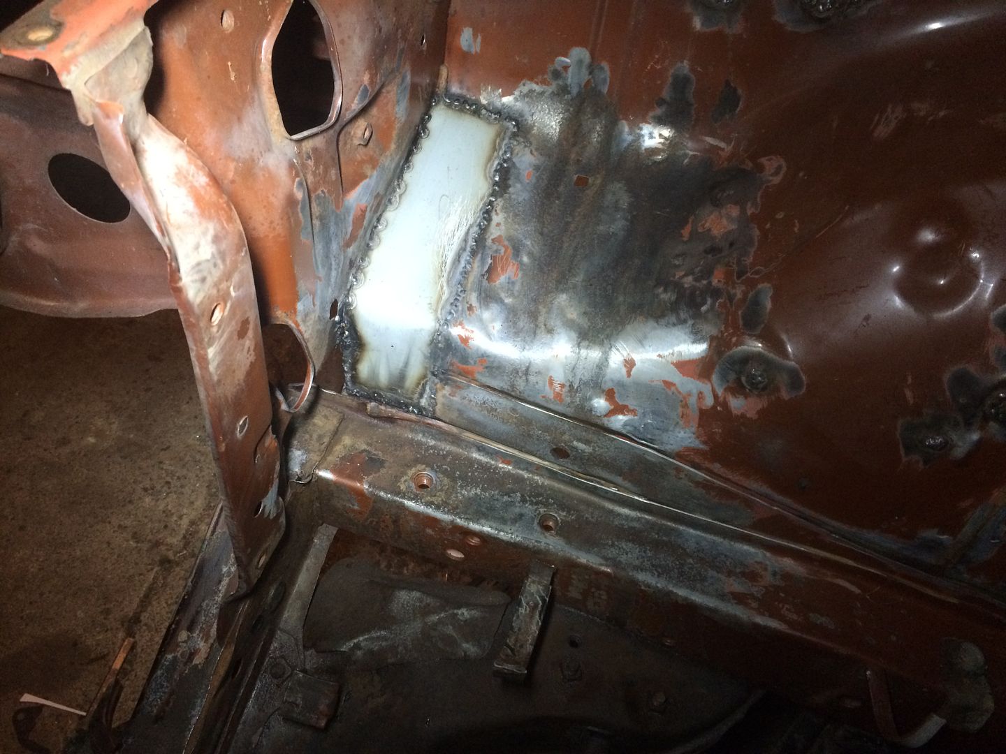

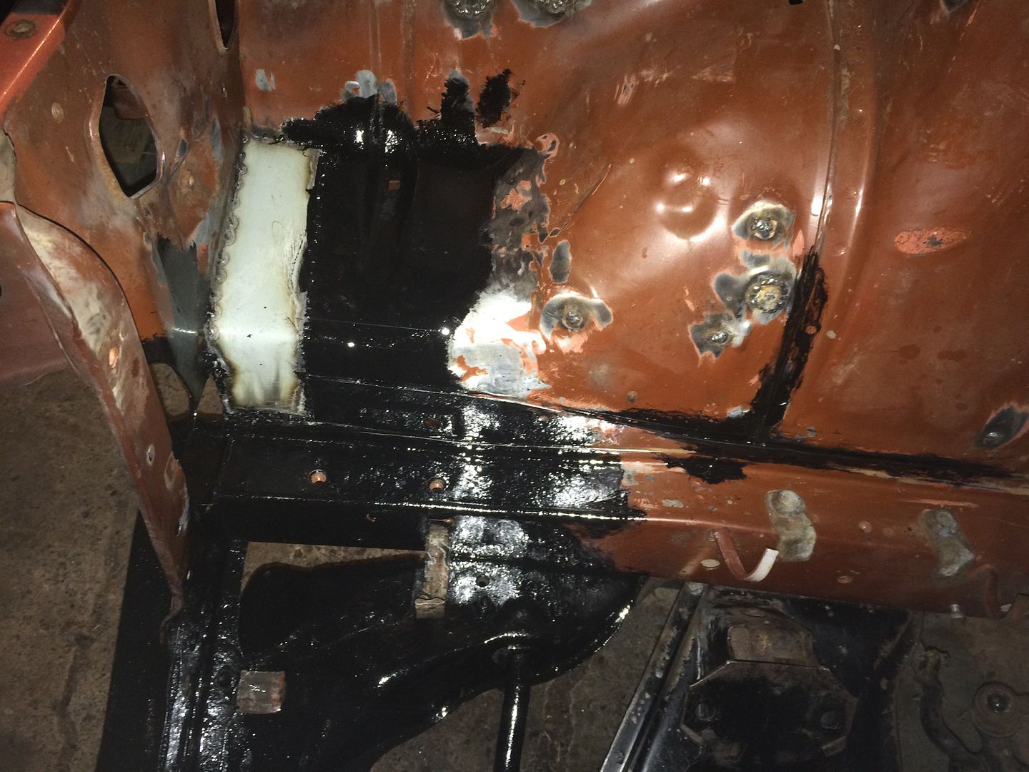

Did some patching last night;
Then I did a little more wire wheeling on the pitted areas and hit it with cleaner and POR15.
A little more patching on the frame rail tonight now that the POR is dried and then it's time to start flapdiscing down all the welds and smoothing it out!

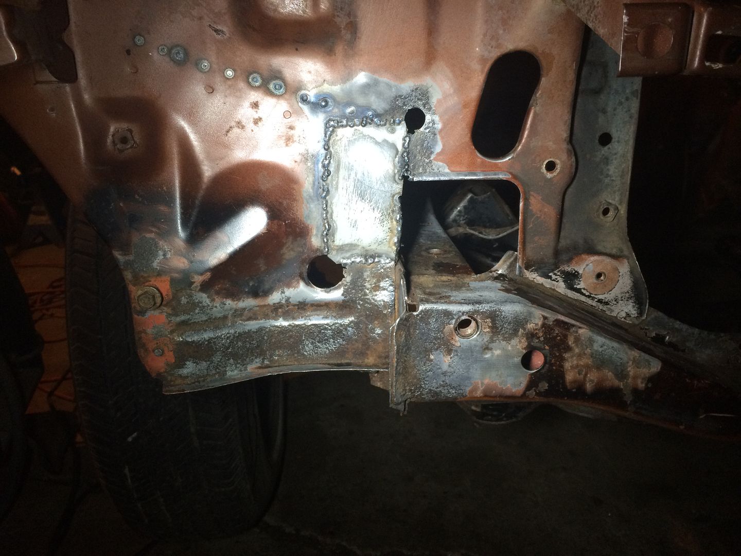

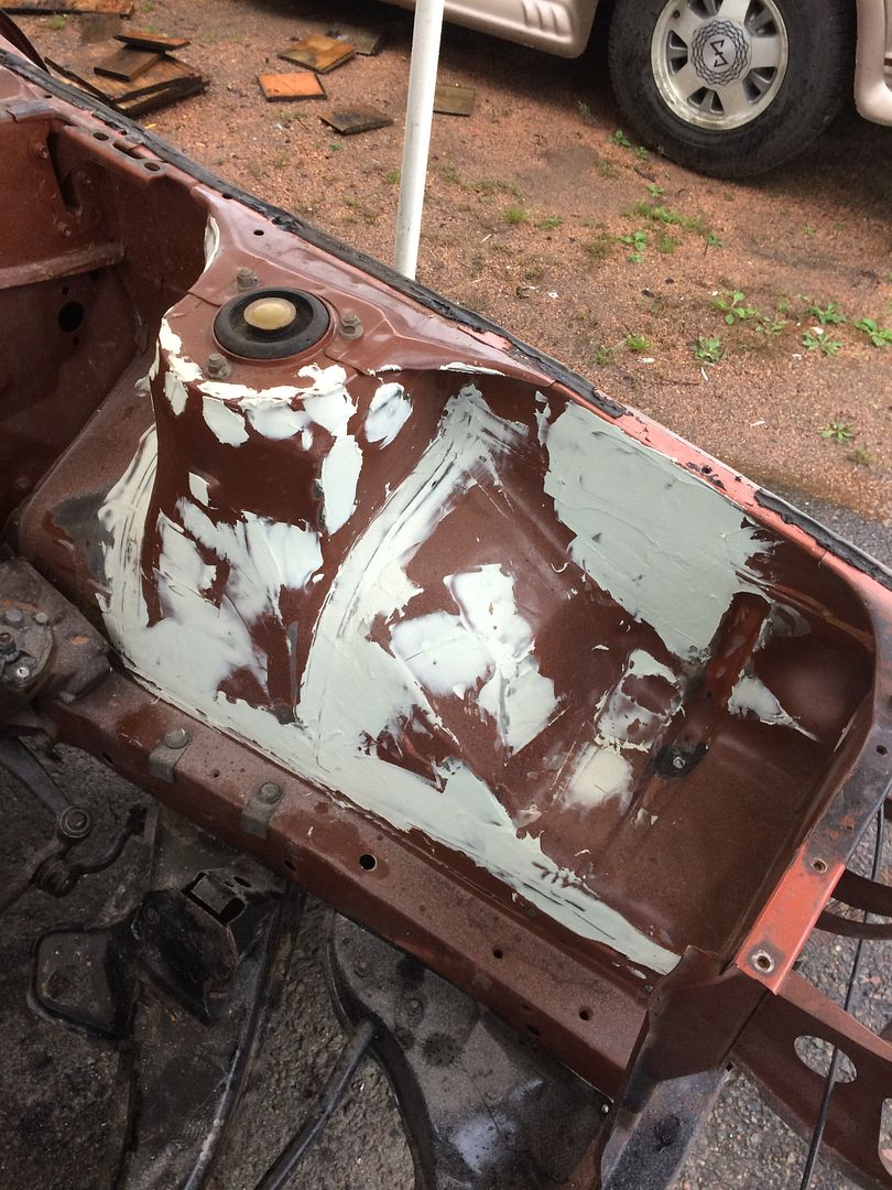

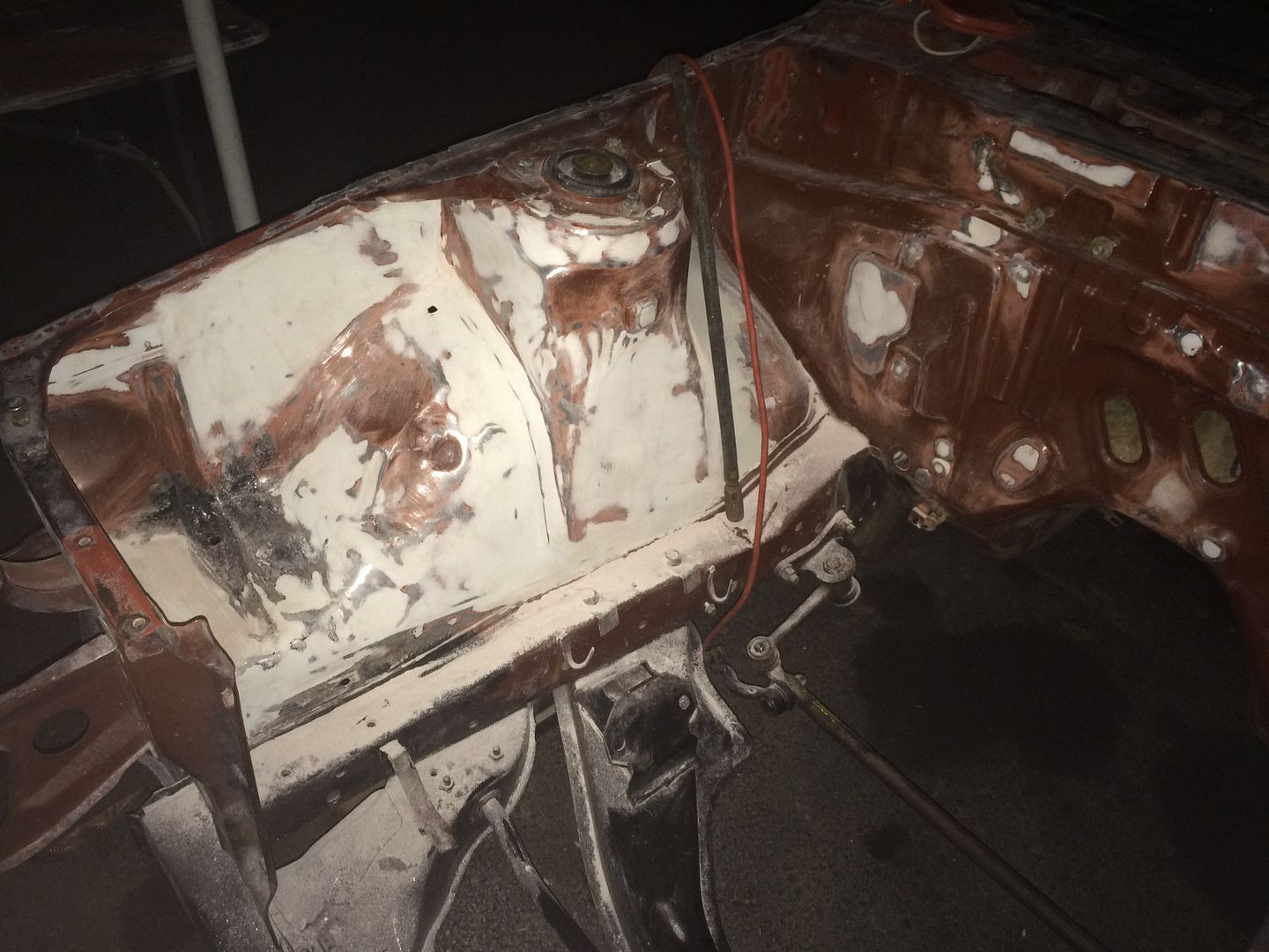

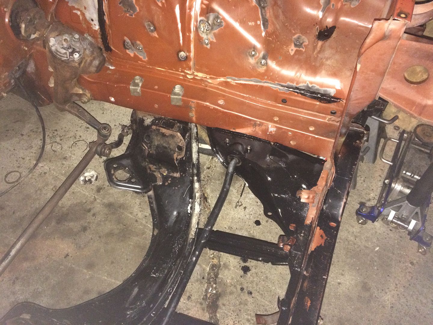

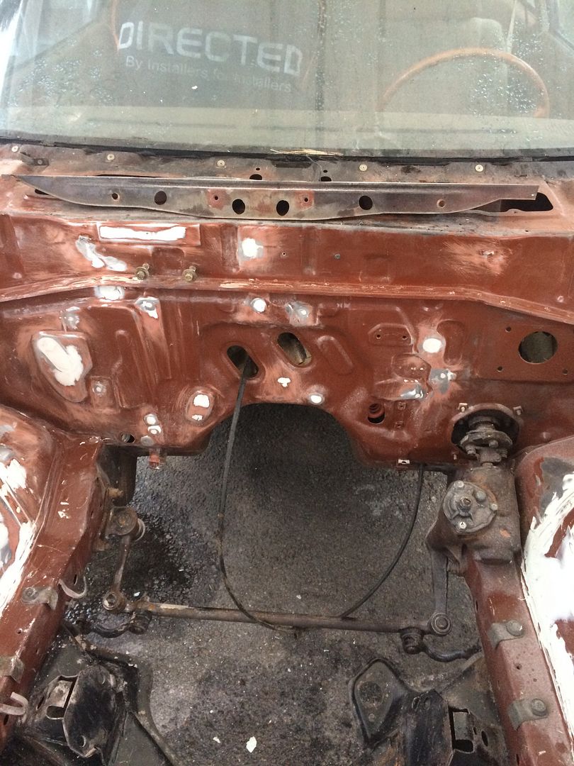

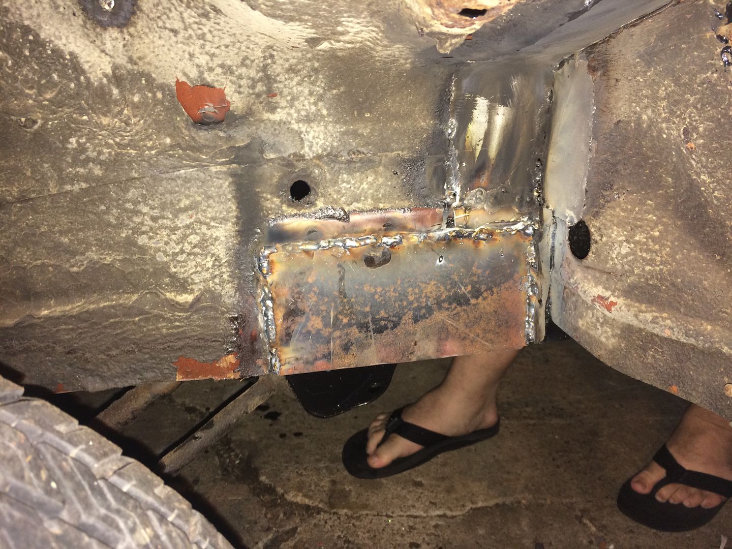

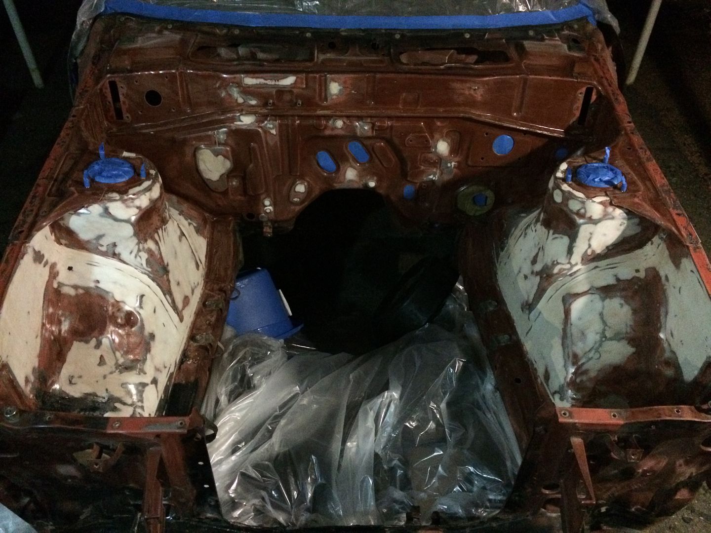

Before I put the NSX in the garage, though, I got more work done. Starting with plating the frame back up. I'm not going to mount the tow hook back up here, seems like they're just good for getting smashed if the front end bottoms out, and if it's lowered that's not a good thing
Then I dressed the welds with the flap disc.
At that point I started wiping mud into the bay to begin the real smoothin.. but I forgot to take a pic.

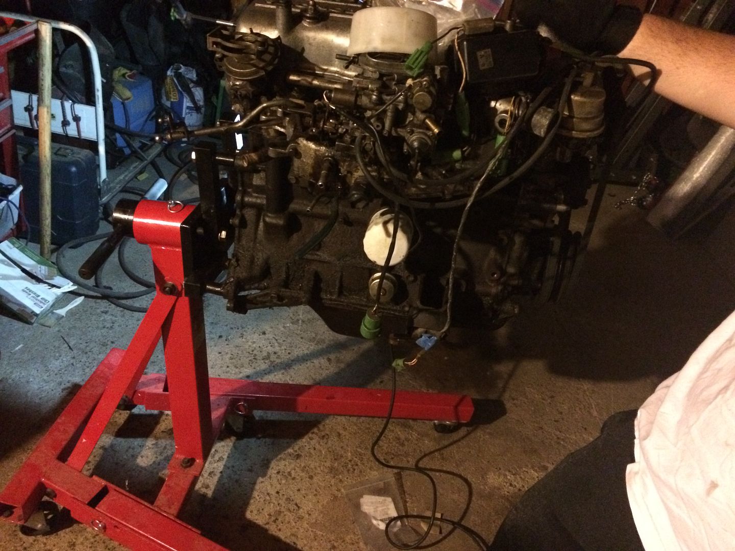

And now that I finally have the bolts I ordered I could mount the 22R up on the stand for when I decide to start the engine work and refresh.

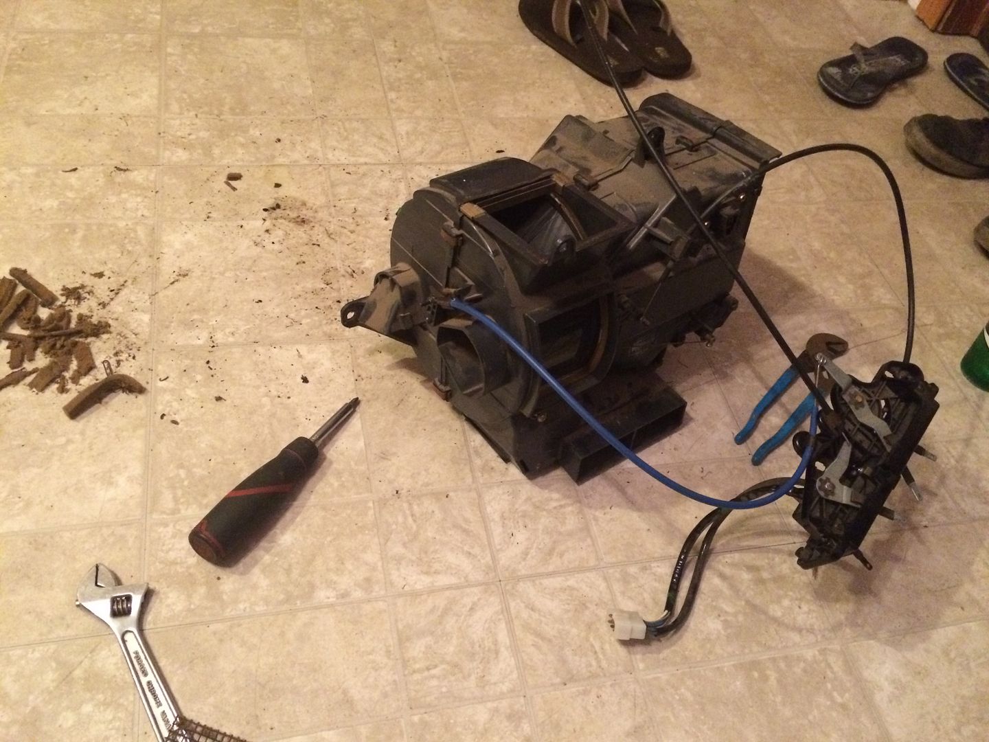

And at that point I decided to retire inside and play with the HVAC a little.

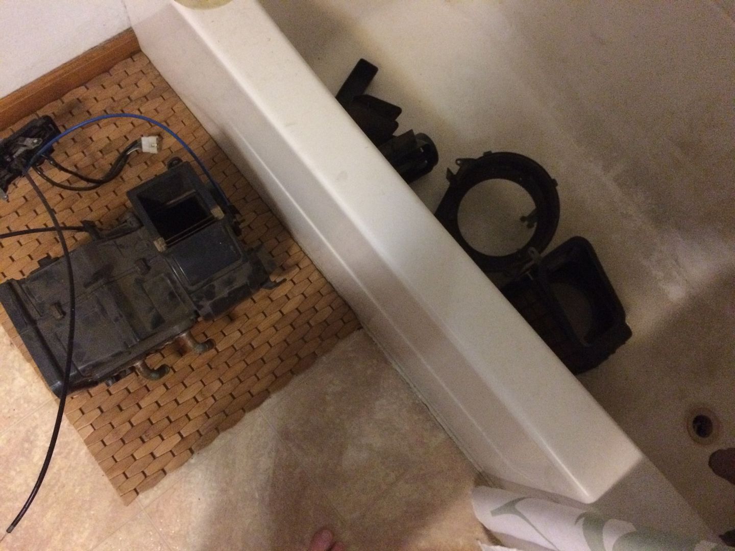

The vent selector cable was broken, and as it happened I had the blue cable extra since I got rid of the heater core blockoff valve.. so I stuck that in there. I can see how the old one broke, though, the way they have the cable attached puts a ton of force on it.. poor leverage design. We'll see how long it lasts.
Bath time
And I started re-foaming the boxes, too. All the old foam had perished.

1) what is this "mud" you push into the divots?
2) that guy welcoming ppl with his dick? Love it.
3) well done.
4) have you considered plastidip? You can achieve similar results for that paint style for about 300$ if you spray.
Offline clutch1
  • Posts: 175
  • Sugoi
Re: Restoring my 1978 project!
« Reply #19 on: Sep 21, 2016, 06:59:09 am »
1. Mud's just slang for body filler, I use 3M body filler personally. Sands really well. I used to use Rage Gold, but this stuff blows it away for sanding ease it seems like. Going to need plenty more to straighten all the little dings in this car, just wait until you guys see the work that's going to need to go into the doors from the looks of it!

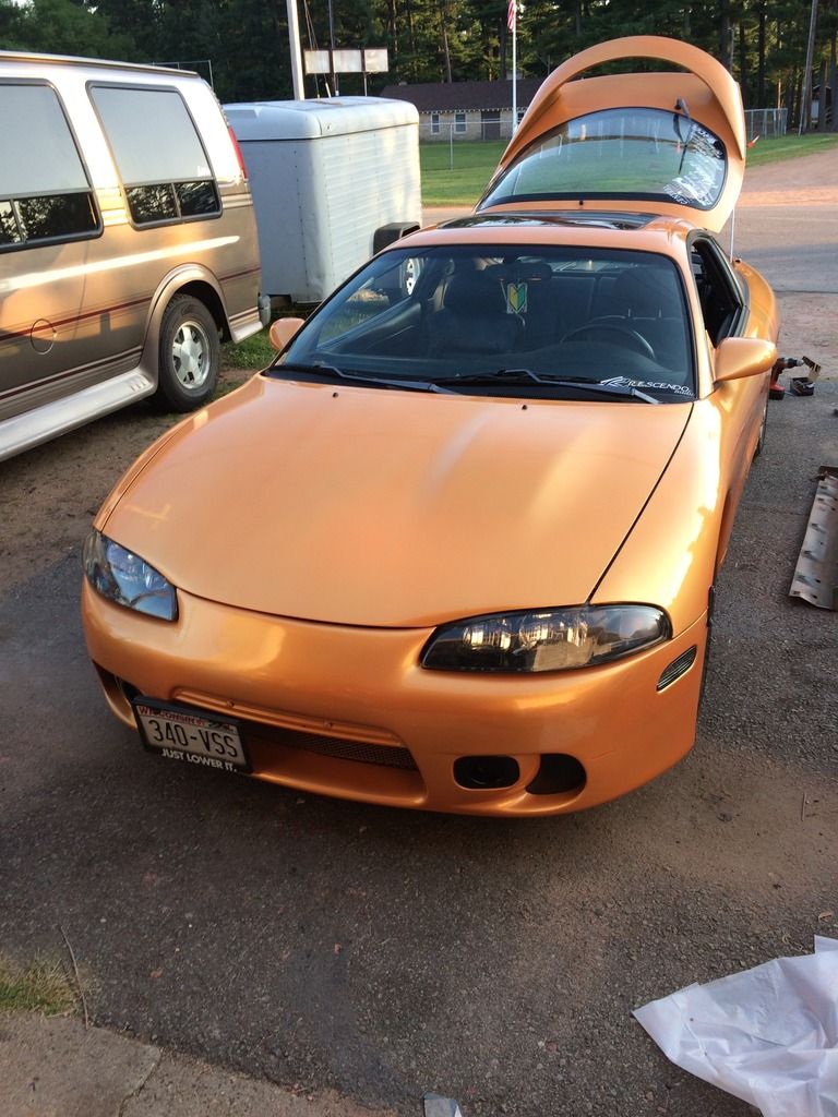

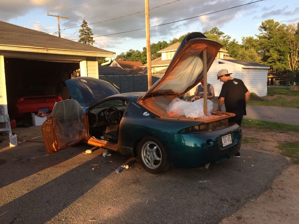

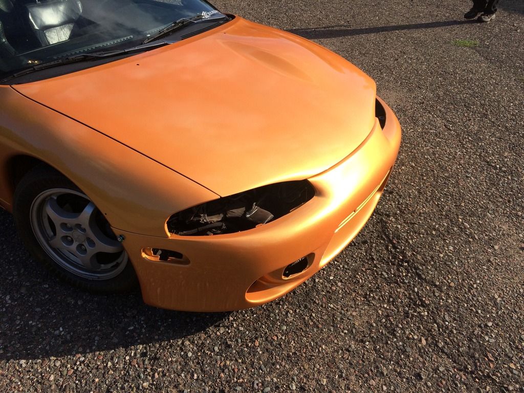

Here's the most recent dip I've done. It's actually done with Autoflex for the gloss topcoat properties. It shines like a traditional clearcoat, vs the satin finish of standard dip glossifier. Very cool!
Because I'm OCD with paint I even jambed it.
Now see the downfall with dip is, aside from the semi-permanent nature of it.. the time and effort it takes to do the actual spraying is nuts, in my opinion. That orange Eclipse was four freaking hours of gun time and about 4 gallons of product sprayed on! I was ready to drop when it was over. There's also the issue of not being able to sand out a run or that kind of thing.
However on a vehicle that requires no bodywork/ repair I think it's a great way to change up a look. It's significantly more user friendly than wrapping a vehicle, which I've attempted with no success in the past, lol;

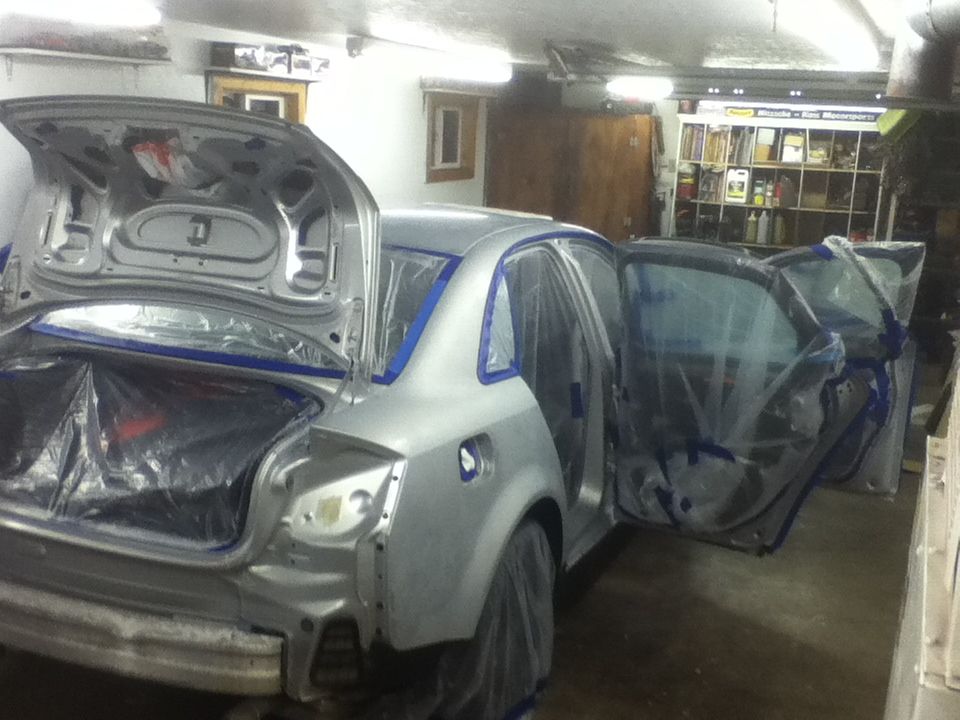

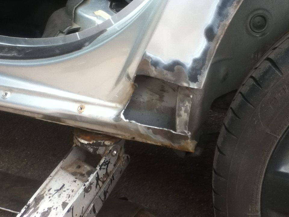

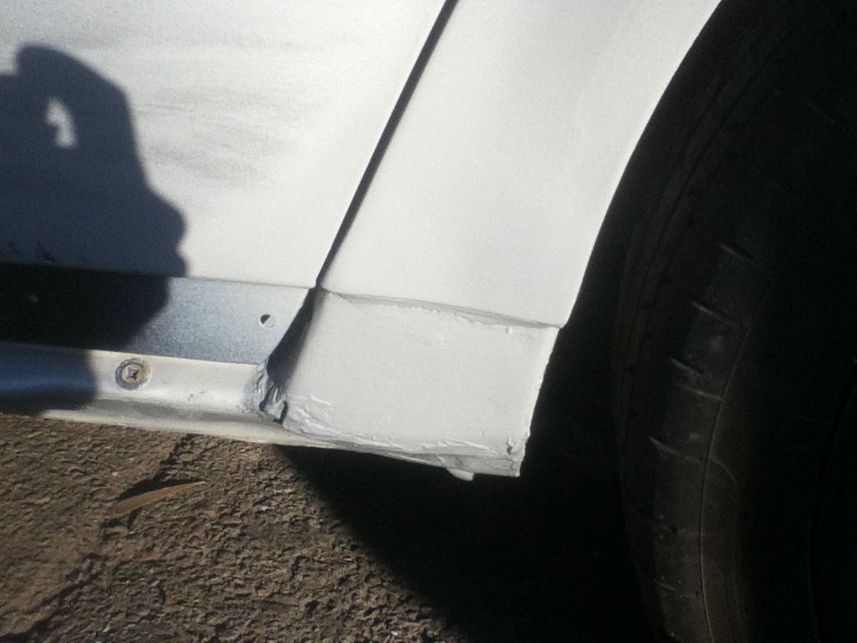

On that same tangent, the first car we were going to do with Autoflex spray wrap / dip / whatever you want to call it was going to be my friend's Audi A4, which needed "a little bit of rust sealing then a quick spray." Wrong!
I got the car and by the end of the first night disassembling it I had to cut out chunks, like this one!
As I pulled it all apart the car told a wonderful story of a shoddy repair from a significant impact. As it turned out the rust side had an after market fender, door skins, rear quarter panel, and half of the rocker/pinch weld. All those panels had rot hiding, it was crazy, and the paint was starting to haze over where it was aftermarket. A very sad situation
By the time it was all over there were new panels stuck in..
But after all of that rust repair work we came to the conclusion "If all of this time is getting poured into this car, spraying on something we could technically peel off with enough effort sounds like a bad idea" and we shot it with normal basecoat/clearcoat.
Tadah!

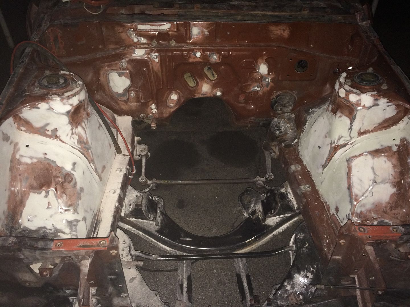

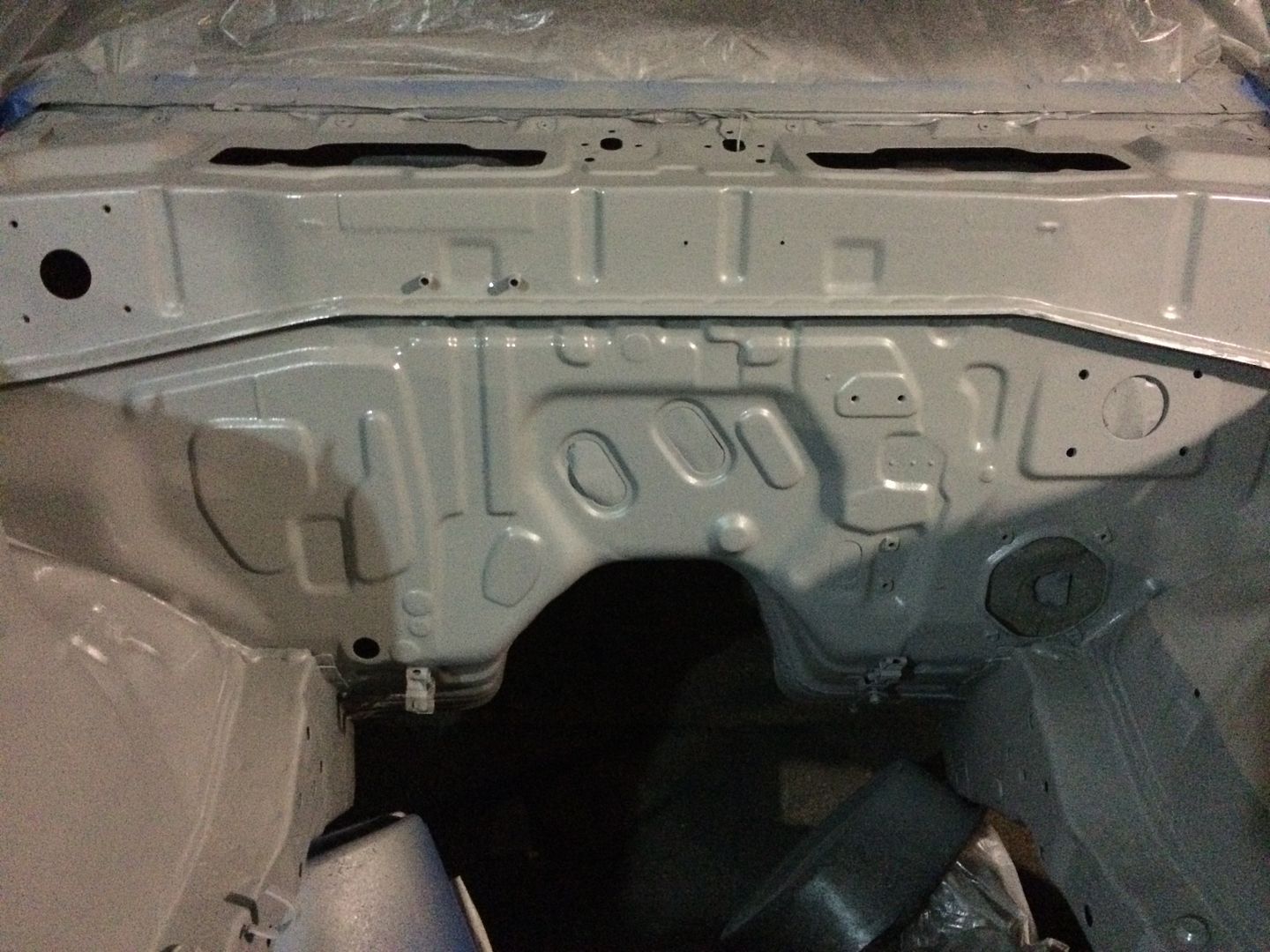

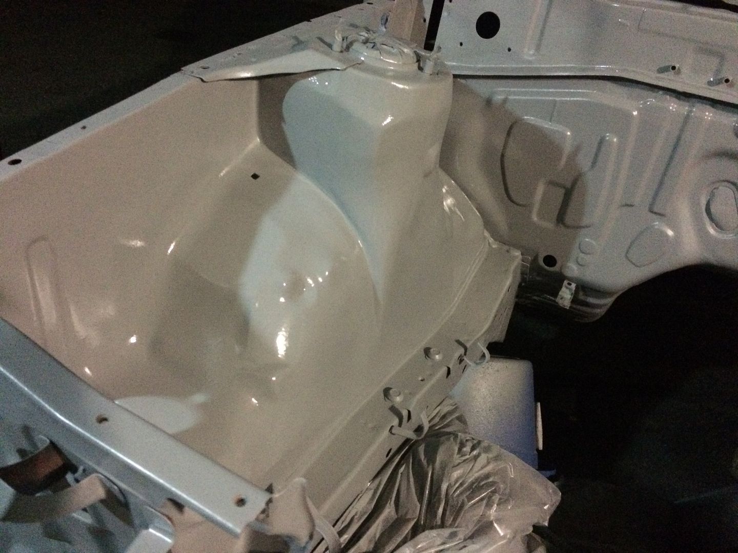

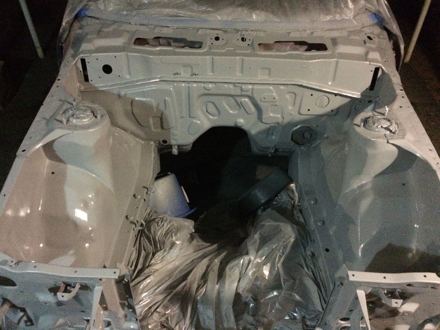

Well, as with anything fun, eventually the fun stops. The welding and grinding turns into monotonous sanding, lol. Sunk some time into it the last couple days.
Round 1 began
Working on round 3 when I ran out of energy for the night
I'd say we're about 75% there for major bodywork in the bay, I hope anyways. Once I get another couple hours of sanding in I think it's going to be time for a nice thick layer of primer and then we where we're at. Primer is great at bringing out the areas that need attention.
A little bit of free time inside and the HVAC boxes now look pretty good, I'm ready to stuff them back in at some point.

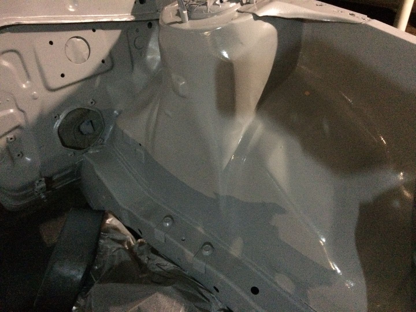

All the sanding culminates in 15 minutes of paint spraying, lol.
It's actually lookin way, way better than I expected. Going to start sanding more tomorrow to see where we're at and when we can do the fun stuff, like real painting.

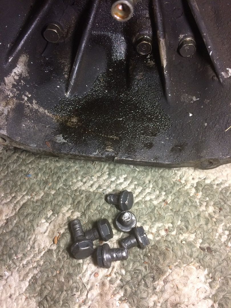

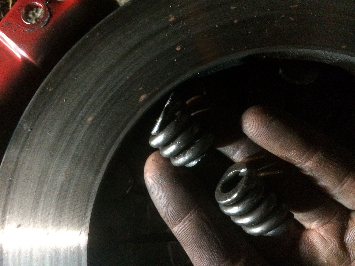

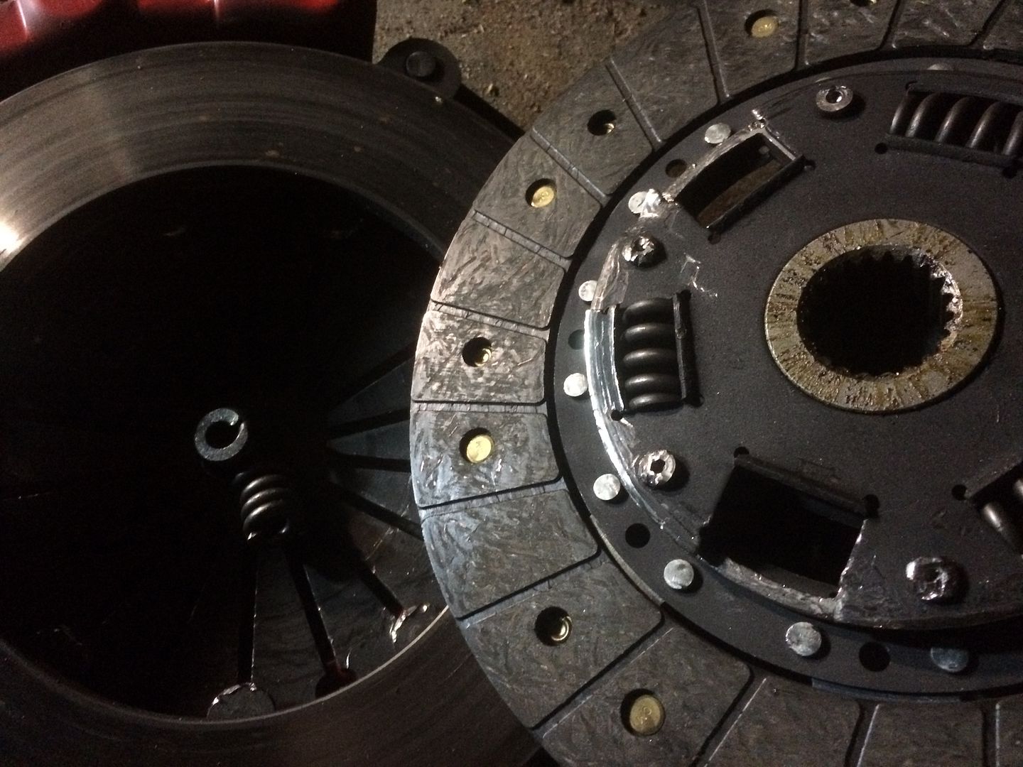

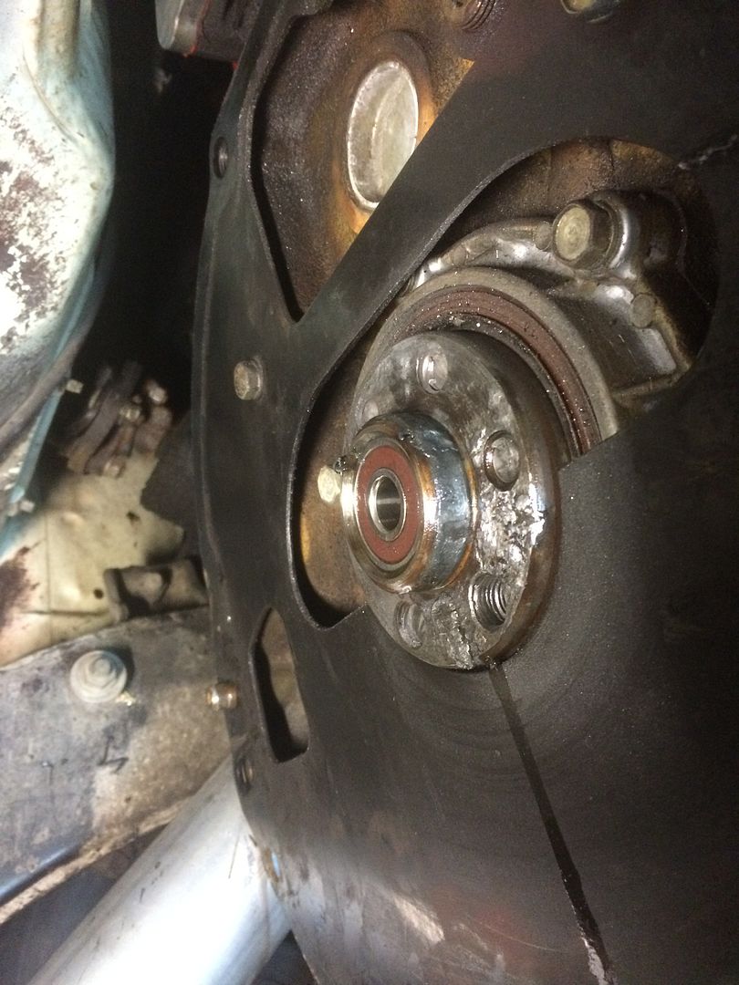

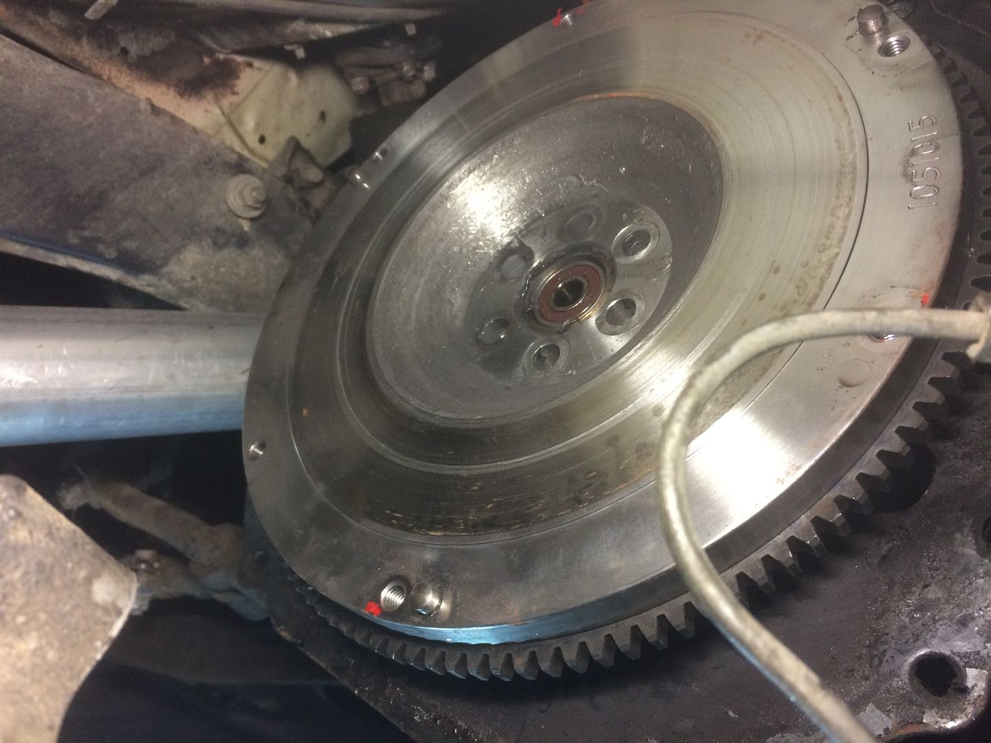

I took a little break tonight. But not really. My neighbor wanted to work on his '78 Hilux, do a little investigating to see why his clutch didn't disengage the engine from the trans.
We started doing a little adjusting on the clutch, and that got us nowhere. I could look in through the clutch fork hole and see the fingers on the pressure plate moving, so that left us with "man there really is something screwed up in there." And obviously when it's 10 at night the only answer is to start pulling the trans. Like 45 minutes later we have a prognosis. Here's how it looked once we got the pressure plate off.
I wish I could've shot a video of it going down. As we turned the engine over to get all the pressure plate bolts it sounded like rocks rattling in that area back there. And as we got down to like 2 bolts holding the pressure plate on I got a glimpse and saw the trouble...
Of course, now we've had a flywheel grinding its way into the back of the crank. So that took quite a bit of trouble to pry off over its little ridge it made.
And of course since it had all those bolts rattling around when it ran it destroyed the clutch disc and pressure plate, too. :(
And after that it was back to sanding on the engine bay of the Celica. Right now the Hilux needs the engine pulled and crank removed and replaced. From what it sounds like he may just do a full rebuild on it for fun. That's an issue for another day, though.
