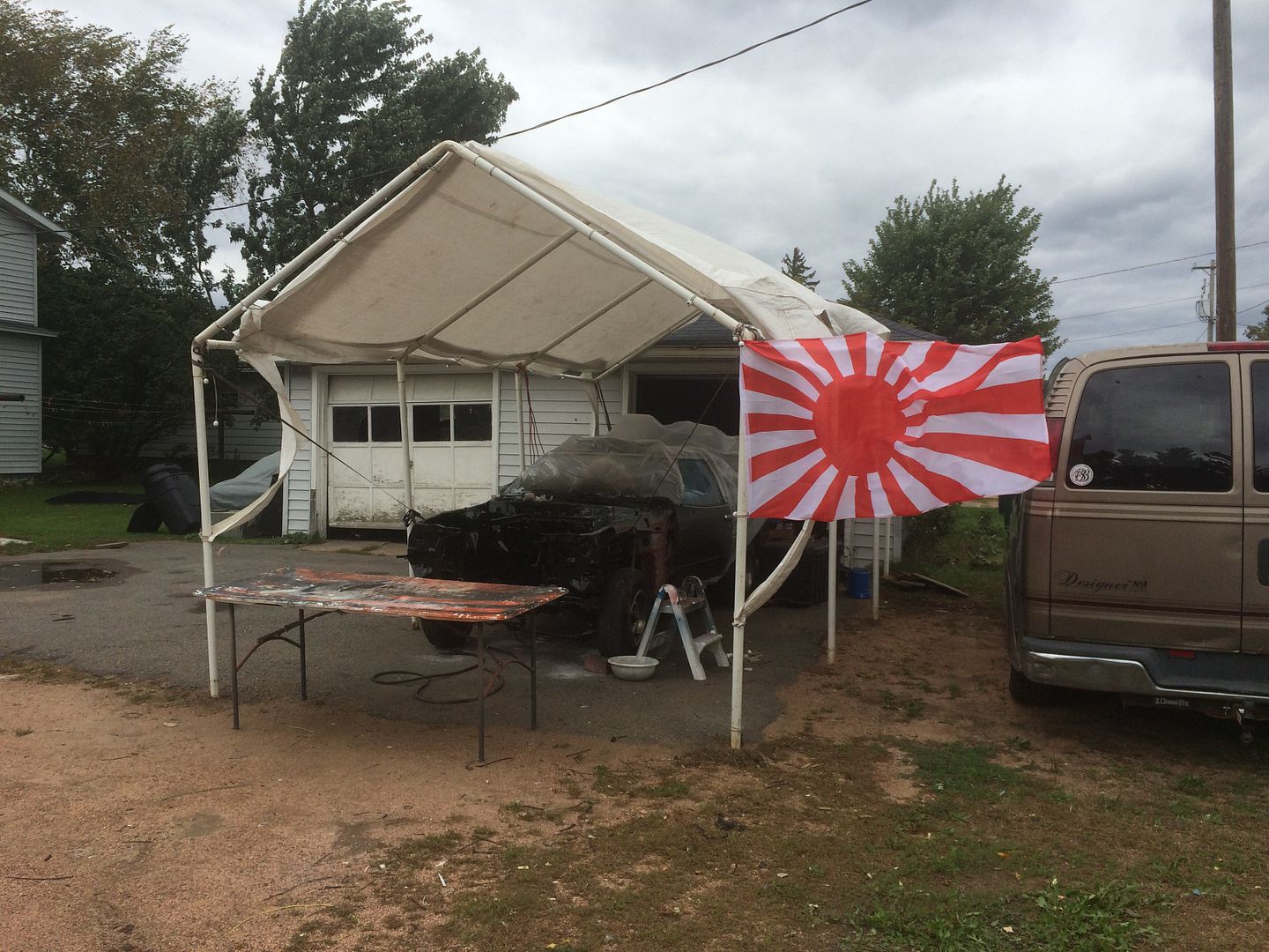

Continuing the annoying weather, there's more wind here than the political debates today. I woke up and my tent was a little worse for wear, one of the poles actually bent! Go figure.

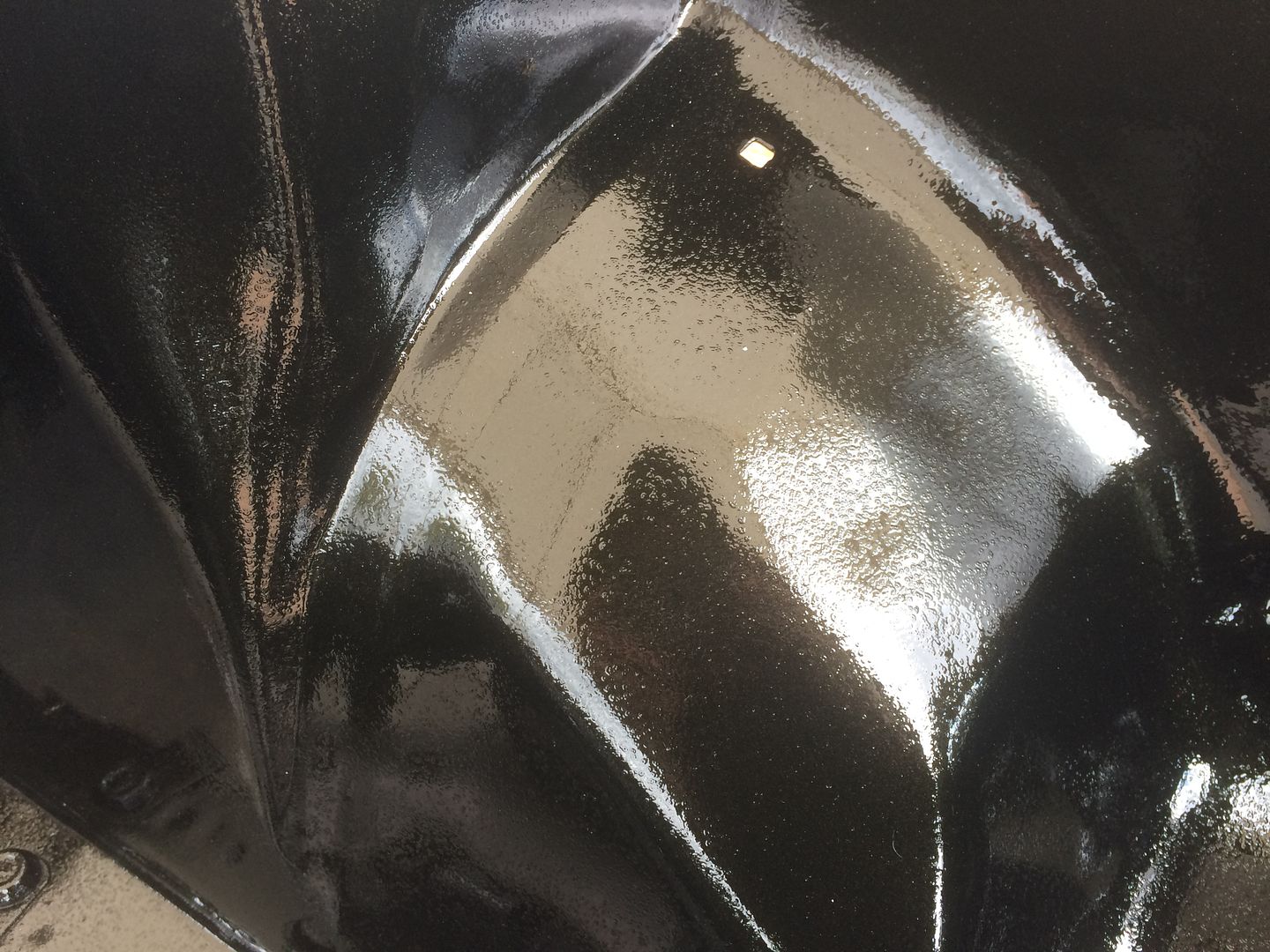

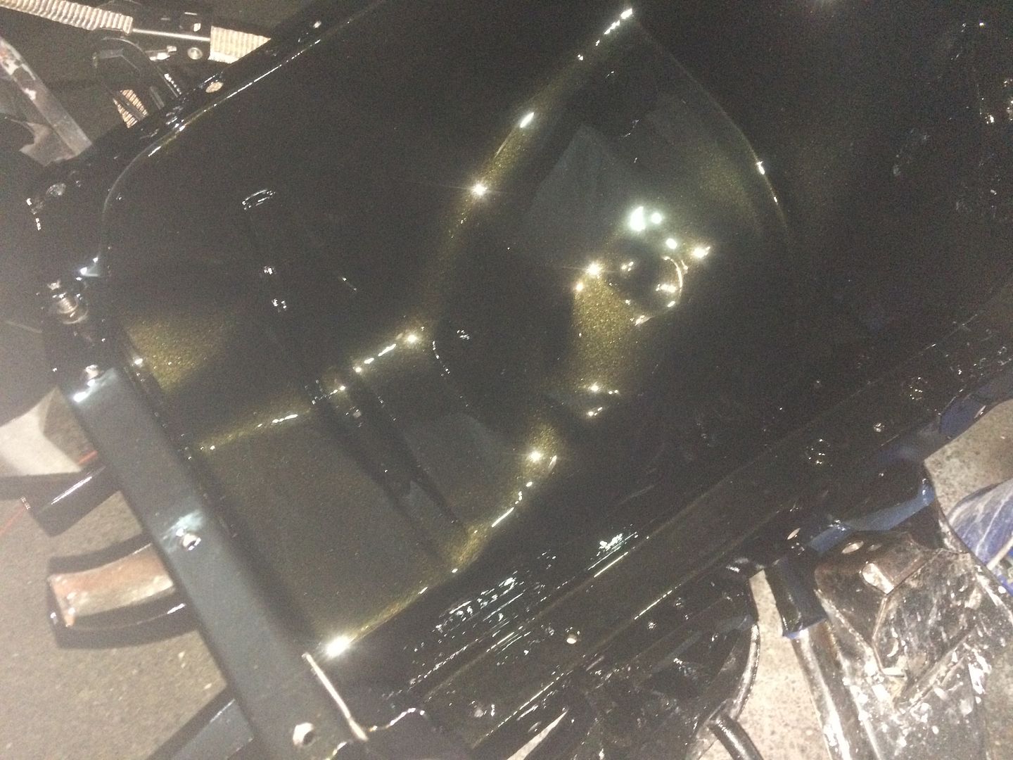

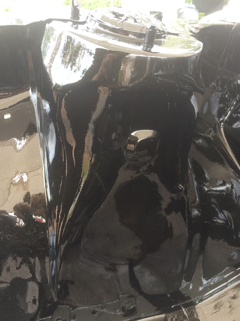

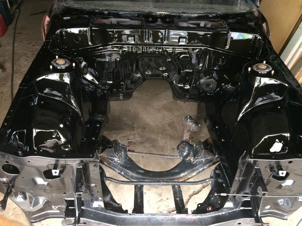

Here we have what rain does to fairly fresh clearcoat..
On the side where rain didn't blow onto it;
Annnd where little water droplets can cause havok.
It looked like this for about.. 15 minutes. Gr.
Time to bust out he 800 grit and sand the whole bay again so I can shoot more clear when it's not going to have a freak rainstorm come through, hopefully.

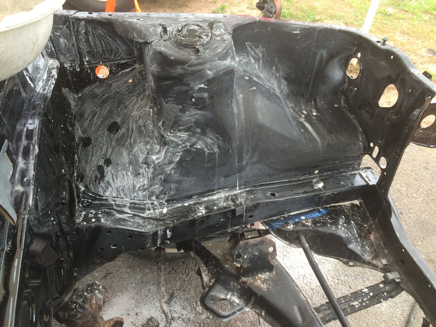

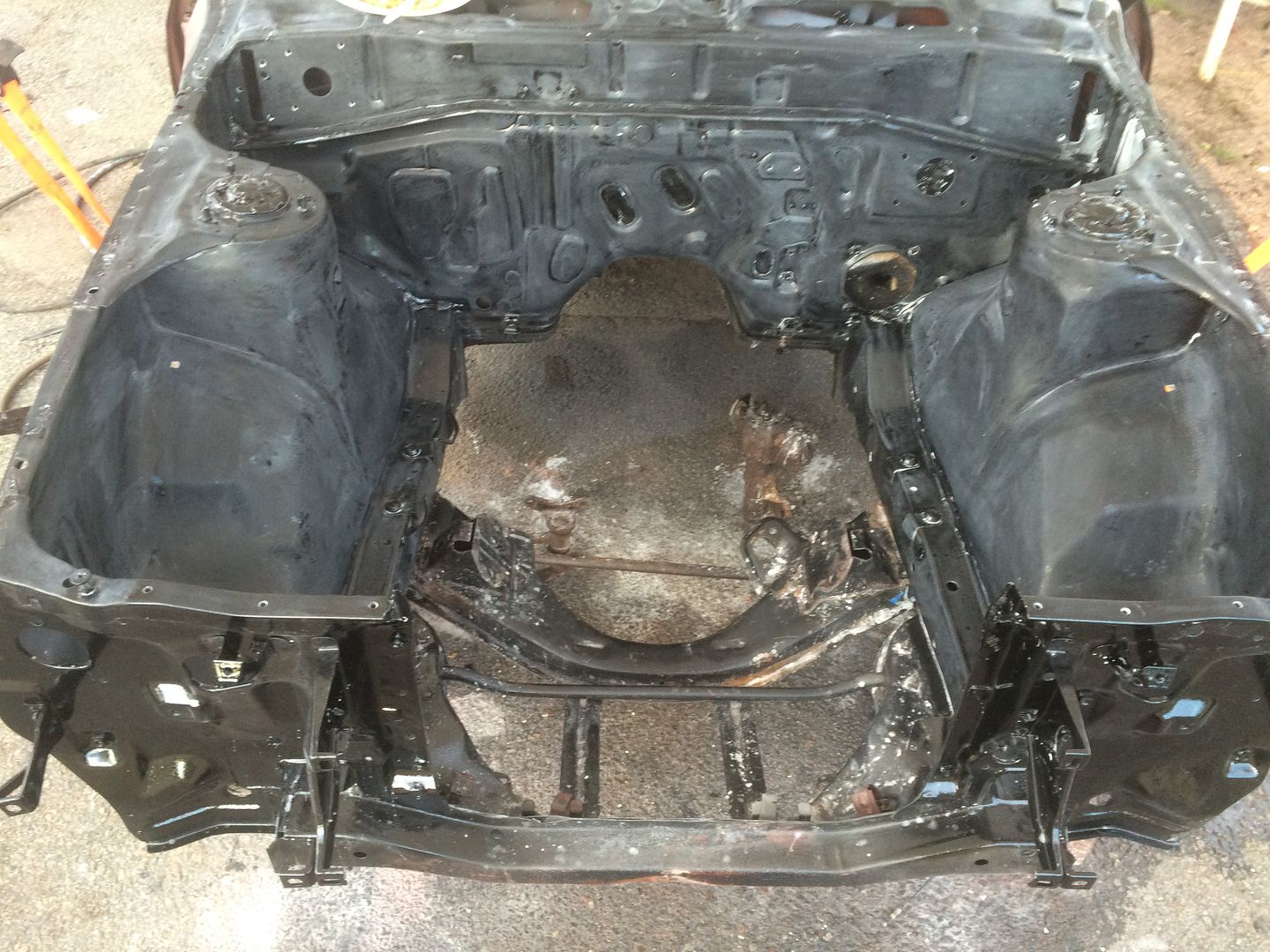

Here's a little profile shot of what I was working with, had to knock the majority of this down so it's all uniform and sanded.
Finally all sanded. Now we wait for good weather.

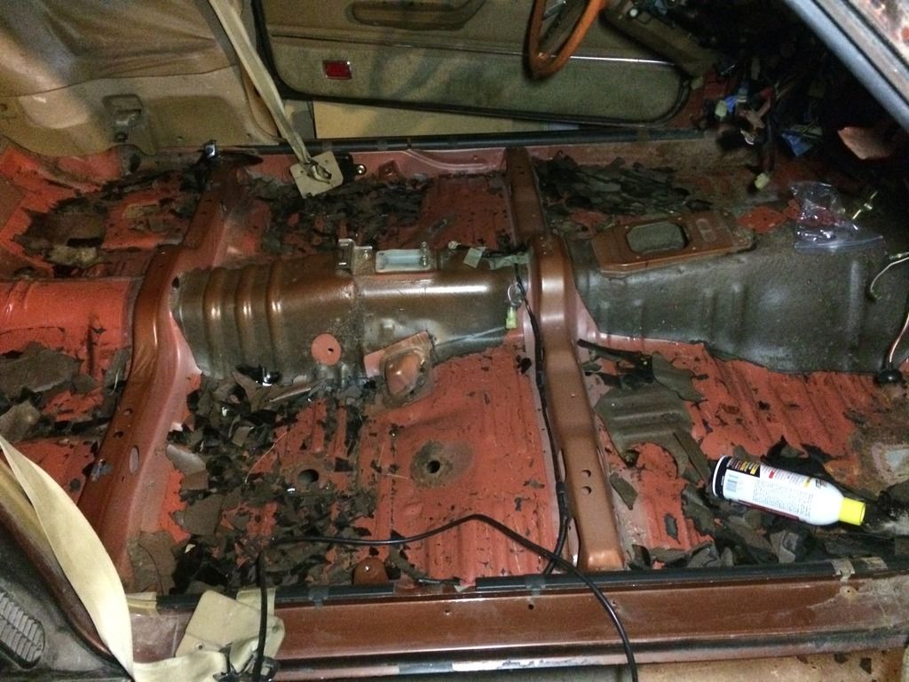

Then I spent the last couple nights fiddling with the interior. I took the carpet out, chipped out all the crap stuck to the floor, etc. I'll have to wire wheel the floor down in the future and seal it up.
I found this, too

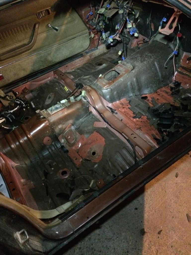

Then I removed the whole rear interior, too. I was pleased to find out that the entire rear quarter window comes out as an assembly. So that means the rotted rail on the one side where the gasket sits isn't part of the car, it's part of the window assembly. Maybe the parts car will have one in better shape! Otherwise with it out of the car it'll be easier to clean up, still.
