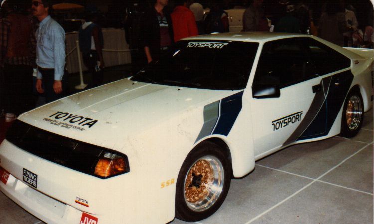

How about some info on the widebody kit?
Re: I can never find my old threads
« Reply #7 on: Dec 01, 2016, 08:31:06 pm »
It's the IMSA kit adapted from Toysport's and AAR's race cars for the coupe with some tweaks like venting the front fenders.
It uses Toysport's front end since it has provisions for turn signals.
