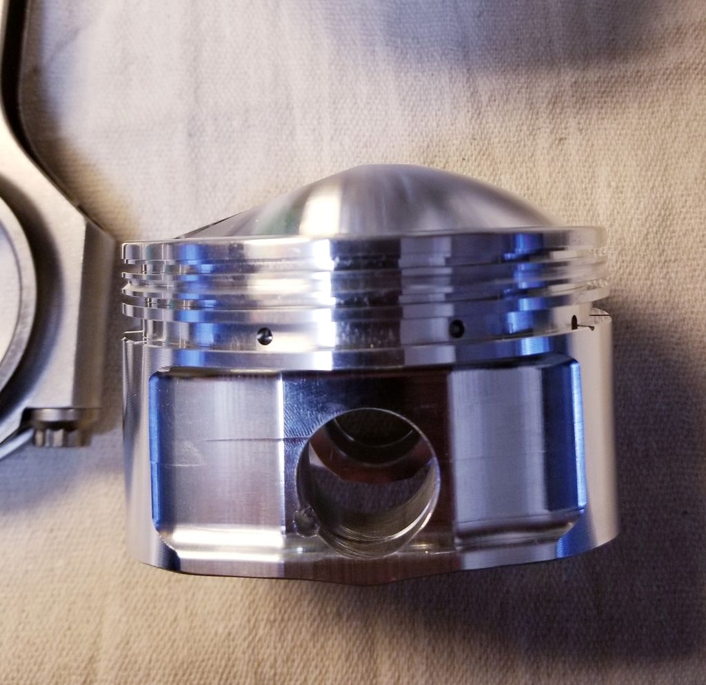

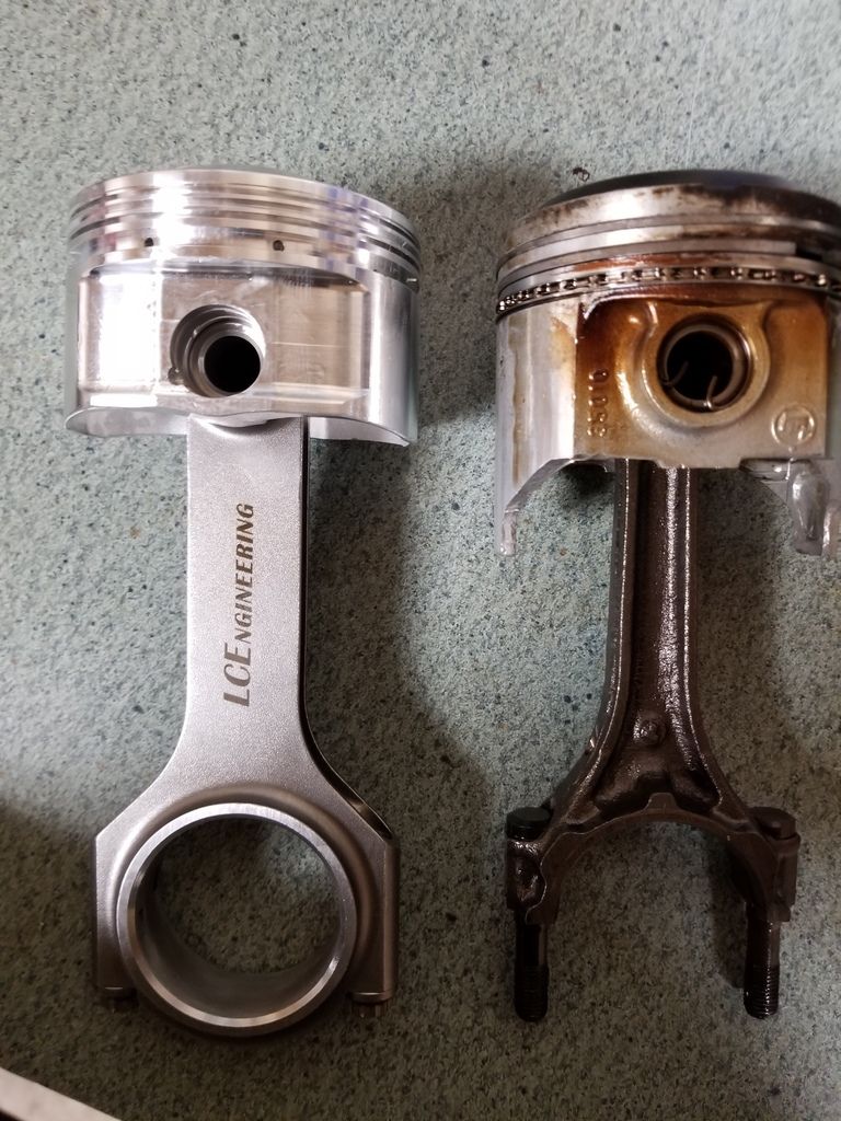

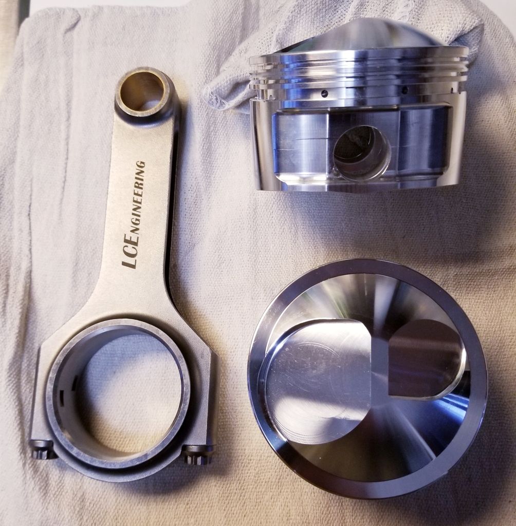

Got carrilo 12.5:1 compression forged pistons and lce forged hbeam rods today now off to the machine shop to have the bores punched put to 94mm 😁 and also install my lce stage 5 valves 40mmexhaust 48mm intake

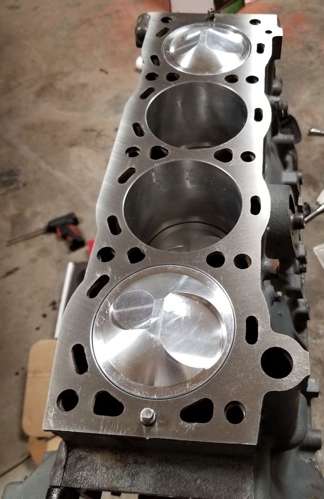

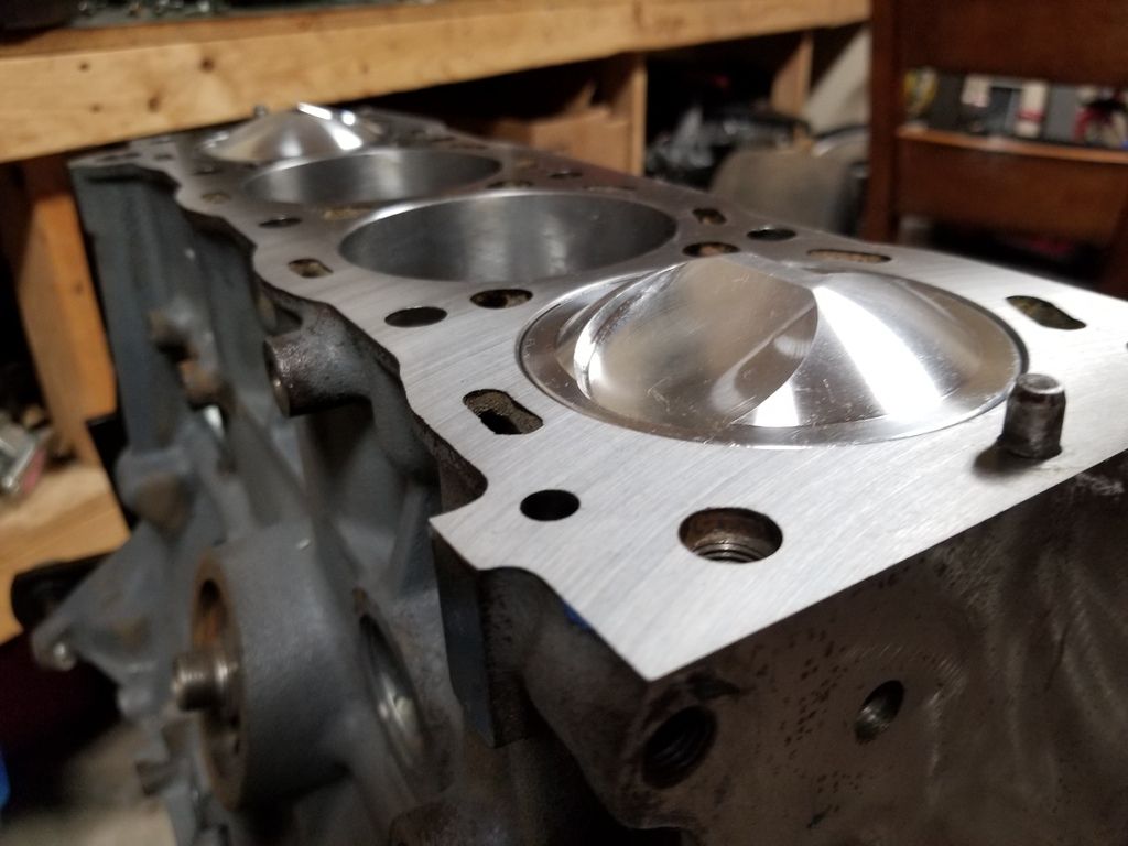

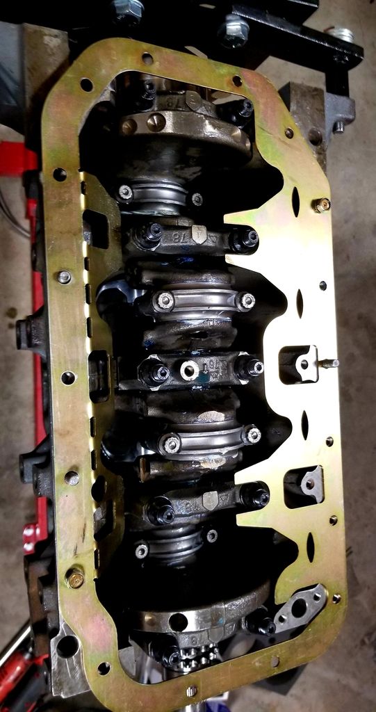

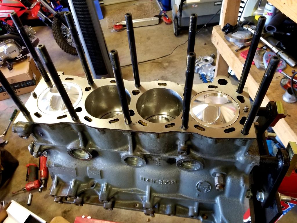

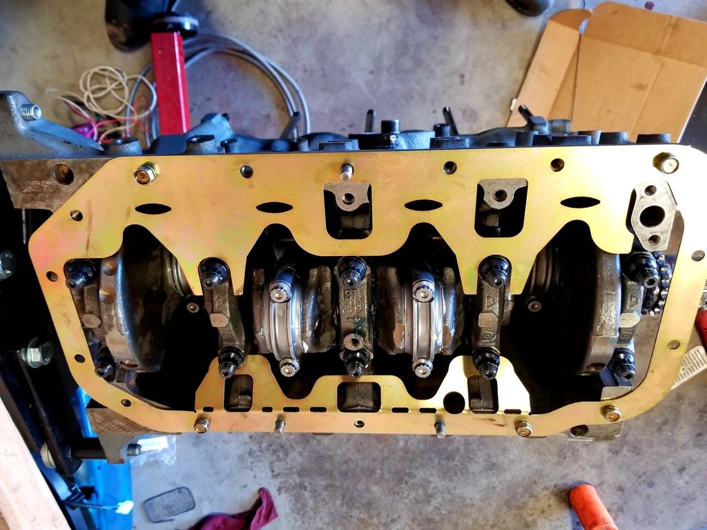

Got the bottom end put together now i gotta semd the head out which may take a few weeks.block work was cheap but the headwork wont be  top ring is gapped at .020 with second ring gapped to .024

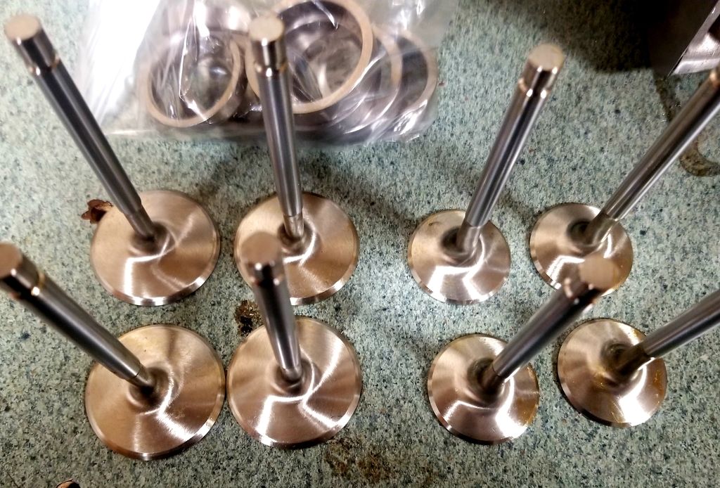

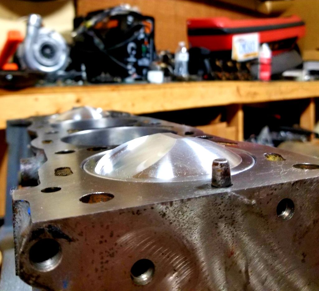

Got the head back,lce stage 5 valves dual valve springs chromoly retainers and hardened keepers. Also plumbed my intake for nitrous.
