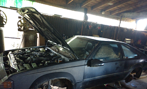

I've been lurking this forum off and on for a couple of years. I have owned my 1984 Celica GTS for around 4 years. I have mainly just kept it road worthy while it was on the back burner as I worked on other cars (IS300 and 280z). Now I have finally pulled the trigger and started a "build" for the Celica. This is my first time truly modifying a car so it should be interesting.
Here's how it sits right now as I work on swapping in the s13 front suspension.

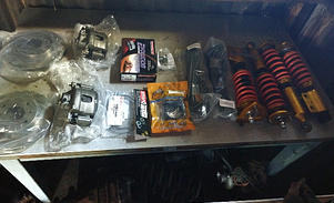

Here's all the parts for the s13 suspension swap. The coilovers are Parts Shop Max Coilovers that I got off craigslist.
The front suspension is in. I still need to hook up the brakes and tighten all the hardware, but the suspension is in!

Looks sweet from what I can see! Photobucket is putting some kind of watermark on there. You might want to try using imgur for uploading photos.
Re: Functions as Intended
« Reply #2 on: Apr 14, 2020, 04:16:36 pm »
on Firefox, rightclick- View Image. Makes it bigger and takes away the watermark.
